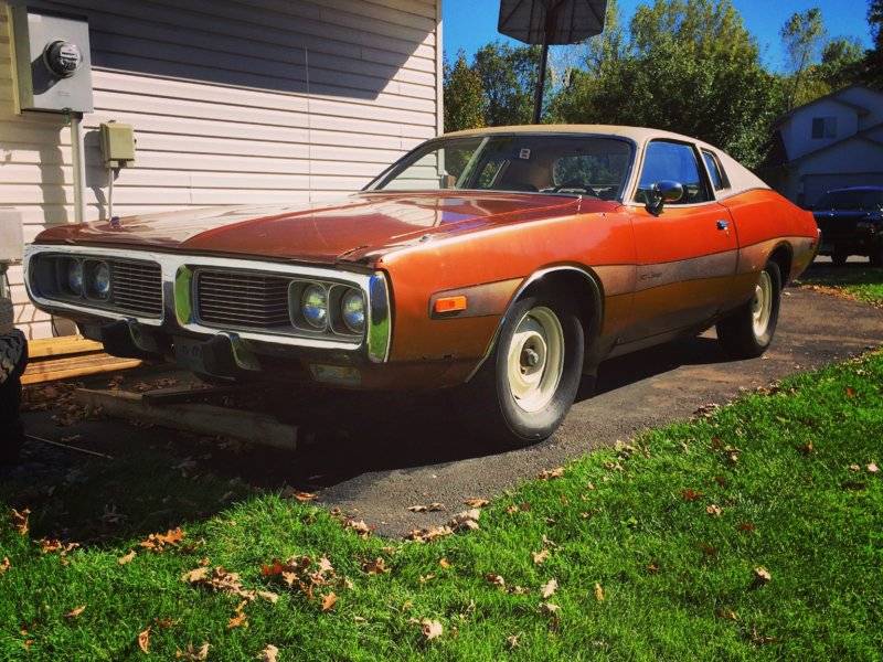

We've had this frankenstein 1974 Charger for a long time.
It is a factory slant six car, but a prior owner crudely swapped in a 318/904 from 1975... The wiring harness is a bit of a gong show, and it has never charged in all my years owning it - making it just sit around and continue rusting in quiet.
We've replaced the Voltage regulator, the Ballast resistor (4-prong), tested the alternator, attended to the grounds, cleaned up the firewall bulkhead connections, and STILL - no charge.
I am so frustrated and I know its hard to diagnose over the internet, but does anyone have any tips for where to look next? Any diagnosis tricks or anything we can try??
thank you guys
