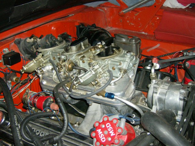

Where on this can i hook a vaccum guage to? I don't have a port in the intake. HPIM0153.JPG
Talked to holley said use any base port on the carb.
As it says above or you can use the choke pull off hose.
I used the port for the pvc valve showed 10 ilbs of vaccum at idle. 6 ilbs in gear
