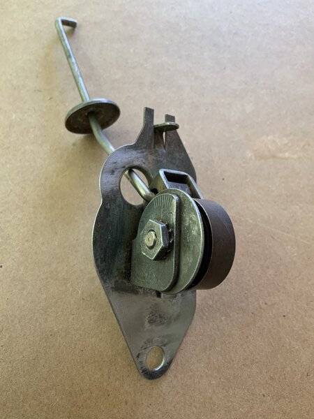

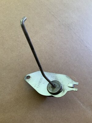

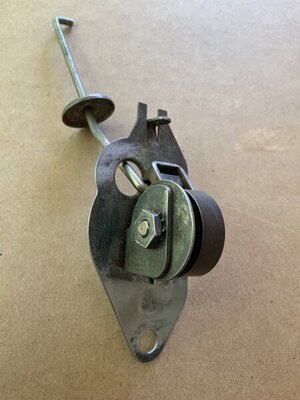

This is an original 67 GTX 440 choke thermostat.
AFE17E7E-B74F-4167-A85F-49113AA7A109.jpeg A60EFFED-A43A-4613-B1B0-E870B14884E1.jpeg

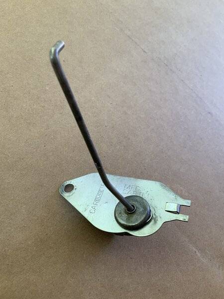

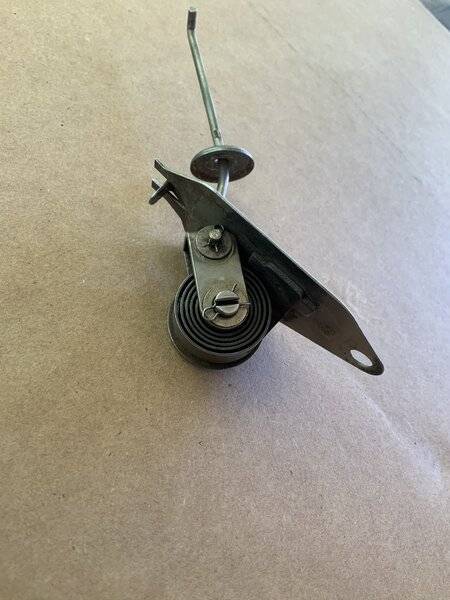

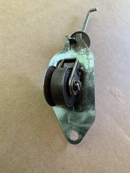

Sure, these are what I took earlier, if you need a different view let me know
C50284AD-0B33-47AA-89F3-69DCBE25937E.jpeg FD553ABB-53A9-4999-8DB4-10EDD56DCB85.jpeg E337D553-D146-4890-B8AC-1E316EBCC074.jpeg
