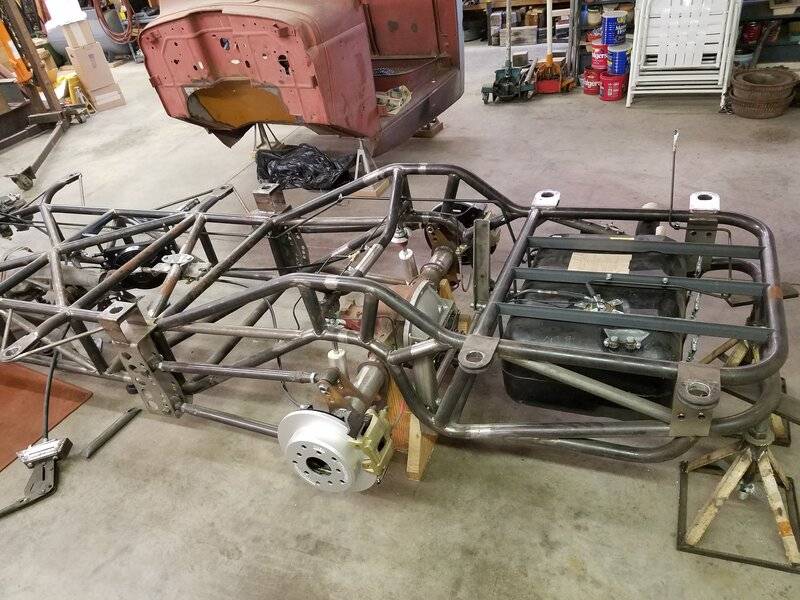

You shouldn't have to tie yourself down
with high $ after market kits. Jeep used
the same axles, and the selection is more
plentiful and a lot cheaper than Wilwood.
The brakes on my rear axle are pieced
together. Ford Explorer calipers, Chrysler
rotors. With a little homework you can find
the backing plates by matching up the bolt
patterns on the axle flanges.
Can't help much on the front as mine are Ford
with rack and pinion on custom A-arms, using
Ford PINTO spindles.
