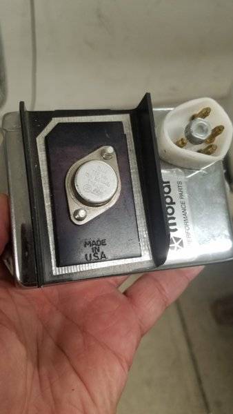

There is one on ebay says new. Can't see any Made in USA, so bbw.
It's not a real chrome box!
Thanks Fran. Yeah the good ones had 'made in USA' engraved on the front, and if I recall some just had a sticker...
