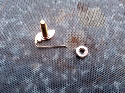

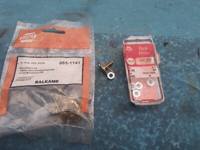

Yes the NAPA ones work fine..
just attached my fender and 1/4 trim using them.
On a 62 Belvedere 2 door Sedan.

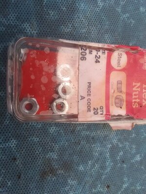

I picked up the nuts at Tractor Supply
