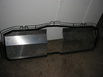

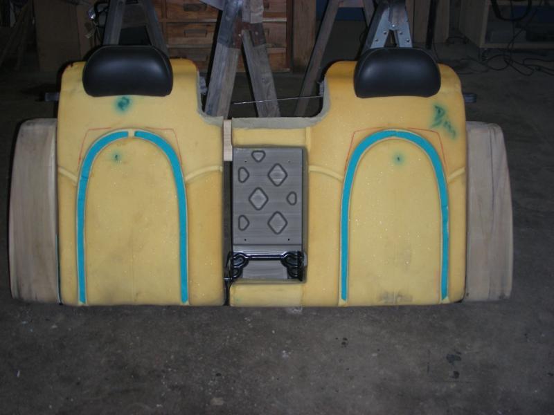

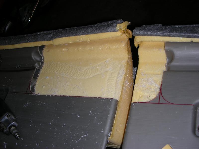

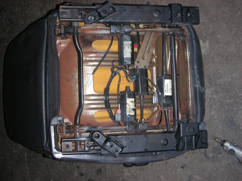

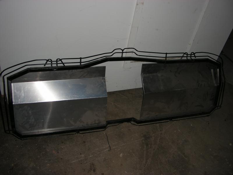

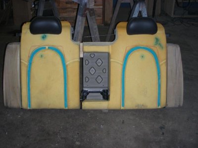

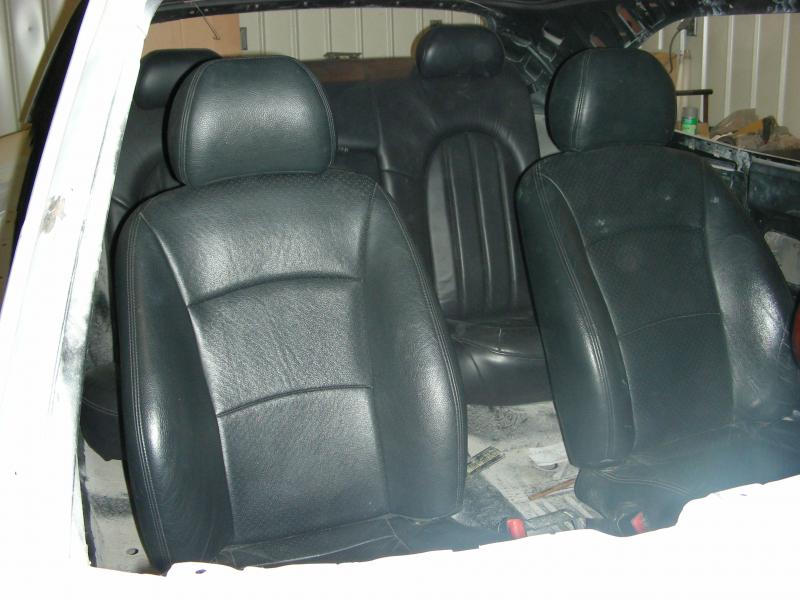

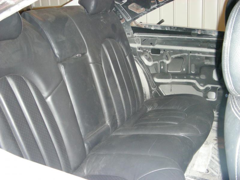

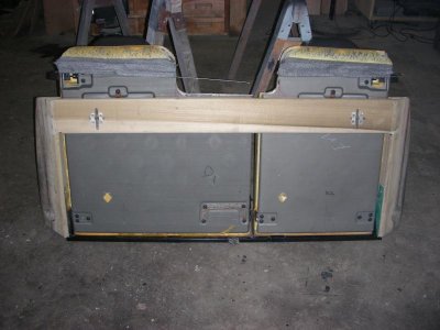

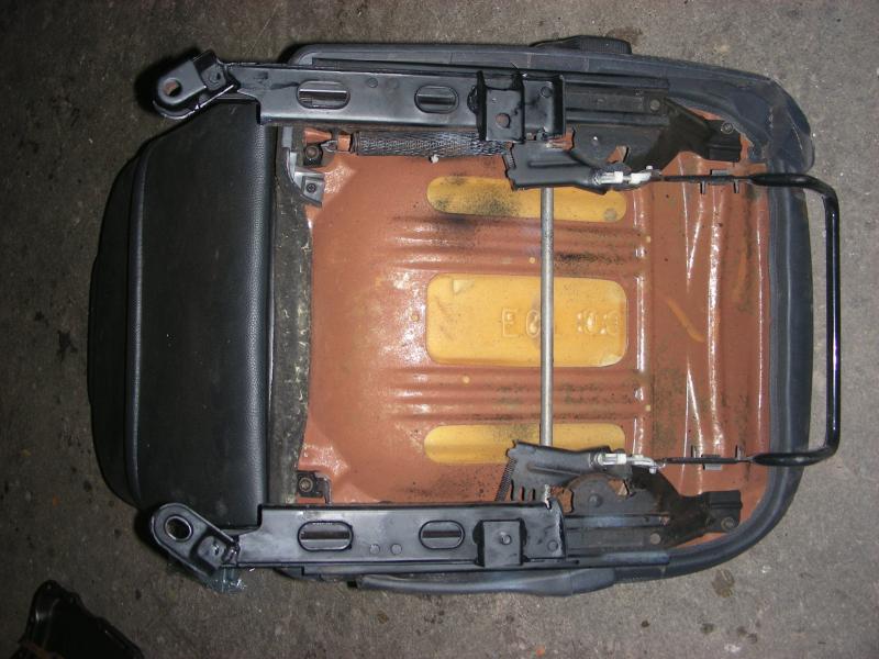

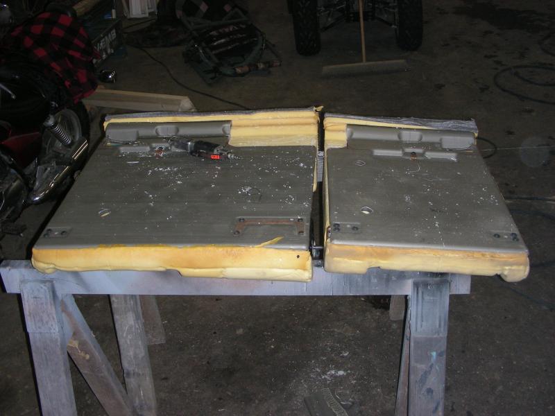

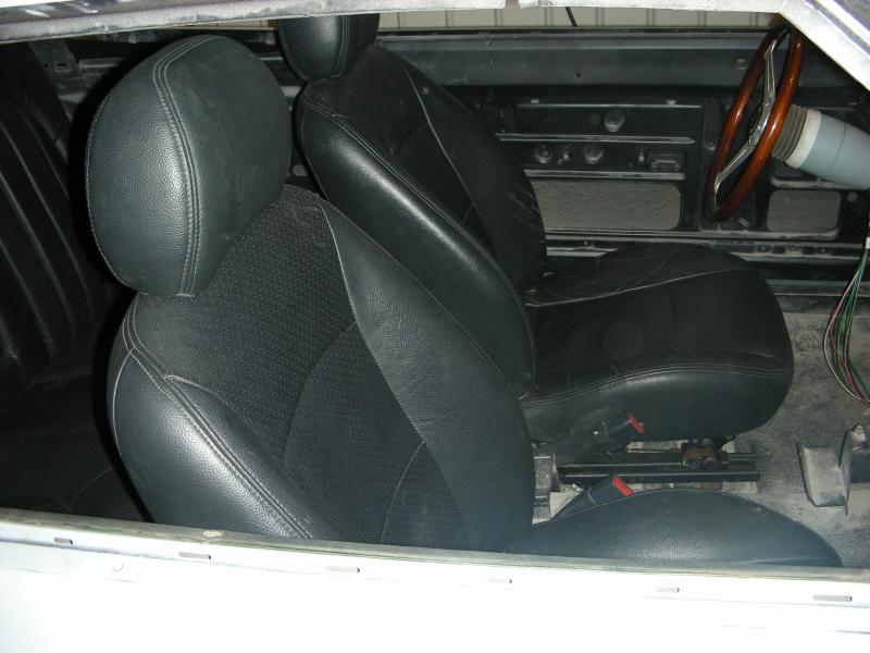

The fronts are out of a 2004 stratus, black leather and power, the rears are out of the 300. The fronts were easy, I drilled out two rivets on two mounts rotated them until they lined up and plug welded the rivet hole shut then made the other two mounts all use the original holes. The rears on the other hand were a pain. The bottom sits directly on the floor in the 300 needing only a 1/4 wire frame to hold the cover in place so I built a 3/4 box frame with an aluminum pan to support the weight. The back was close, it was slightly narrower and to tall (blocked the rear view mirror). I made a new frame out of wood making it a little wider and even with the speaker tray. The back was really comfortable with the headrest so I only removed the center (even with speaker tray) and rounded the corners off. Everything fits and looks great. It's all at the upholsters now getting done in black leather with orange stitching to match the car. DSCN6831.jpgDSCN6825.jpgDSCN6835.jpgDSCN6834.jpgDSCN6824.jpgDSCN6823.jpgDSCN6901.jpgDSCN6899.jpgDSCN6900.jpgDSCN6832.jpg
