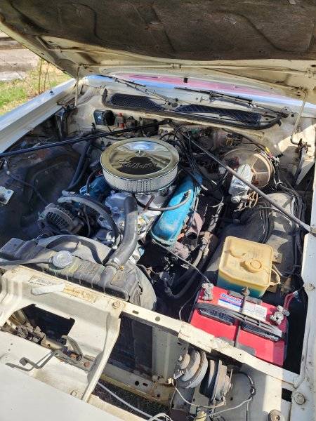

Good day,
I recently purchased a very low milage 1975 fury custom 2-door. The second owner installed an edlebrock four barrel intake manifold to match the engine as well as an aftermarket 4-barrel edlebrock carb with electronic choke. He removed most all emissions controls prior to my purchase. Stock 1975 timing with a factory set up 2-barrel caeb indicates 2 degrees before TDC. Looking toward 1977 when Plymouth offered a 4-barrel set up for the 318, the 1977 data shows 10 degrees before TDC. I have noticed a valve chatter inside the engine under load while driving within a certain rmp/load limit traveling down the road. The noise goes away as I let up on the gas. Does not chatter at idle. My engine is currently timed for the 2 degree mark, I have checked it. I now have a 4 barrel carb on it. Could changing the timing help compensate for the 4 barrel? I want to cure the valve chatter since I am now running a entirely diffrent carburetor therfore now some-what modified. The engine is a stock civilian 318 passenger car engine. Only mod was the intake and carb as well as air cleaner. Looking to cure the valve chatter to keep the low milage engine in good shape and preserved. Do I need to change the timing with the 4 barrel installed?

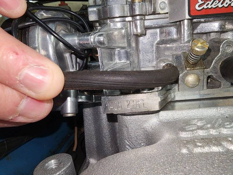

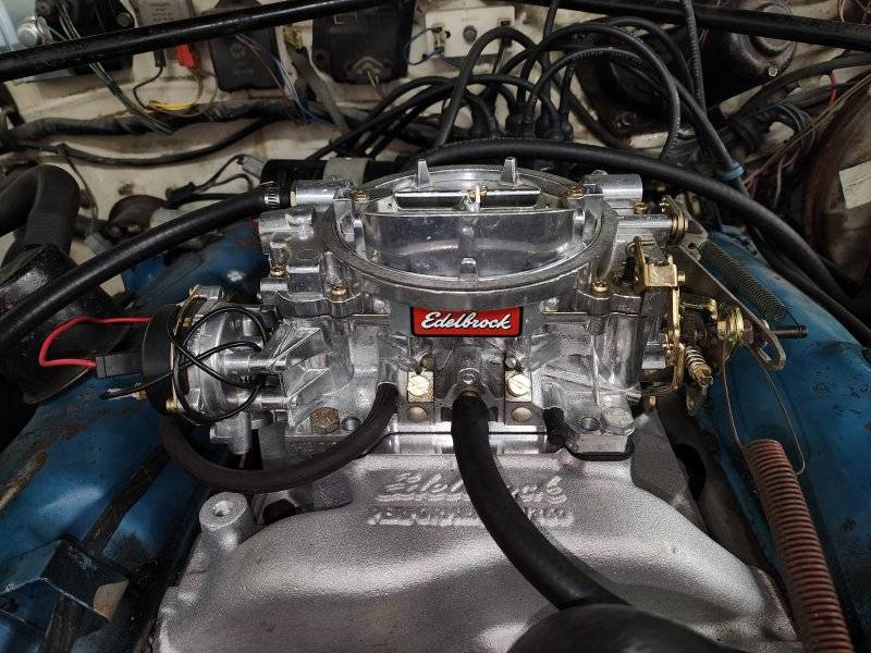

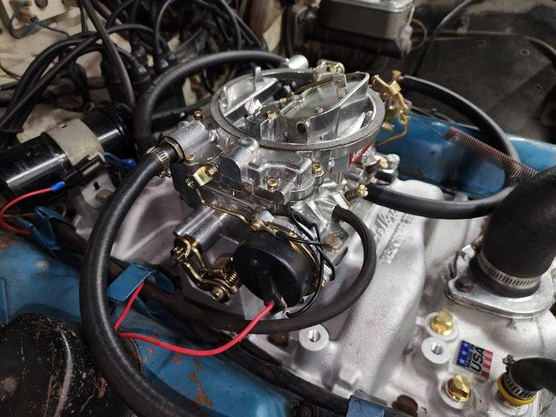

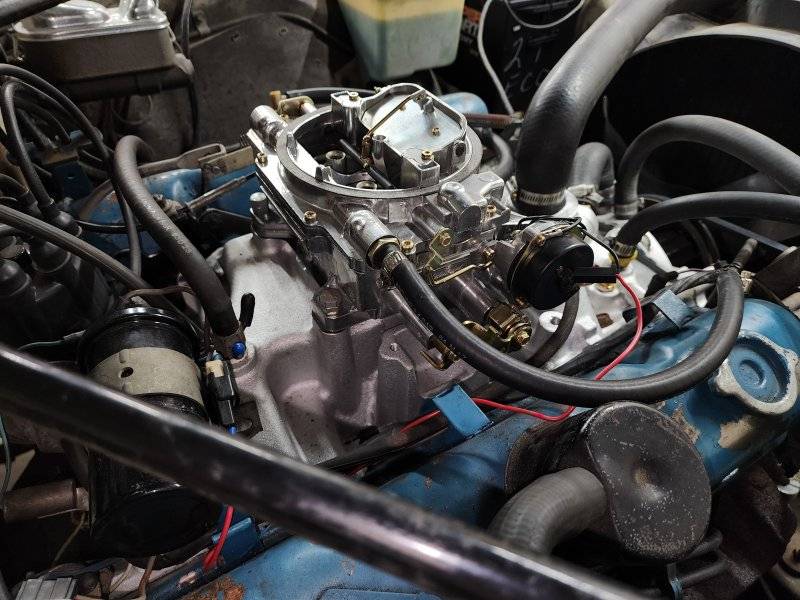

The cords can get wrapped up in a spinning fan very easily. THere are a lot of good direction from the posts above. SHow us a picture of where the vacuum advance connects to the carb.
Thank you all for the tips and information. Here are pictures of the 4 barrel carb and intake manifold.

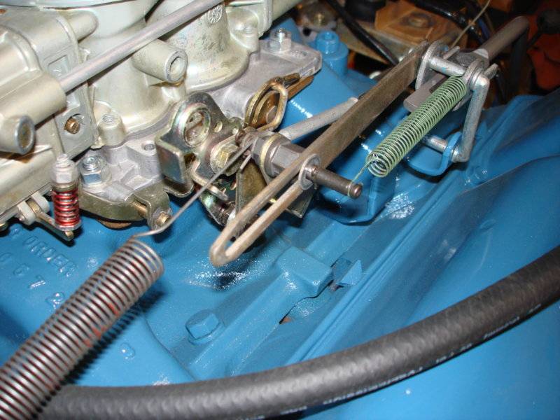

This needs to be adjusted properly. The pin on the carb should be at the back of the slot.
Hello, could you please specify a little more? Do you mean in this picture?
Wanted to provide an update as I worked on the car yesterday. Utilizing the amazing timing gun mentioned above I was able to t
Yes that picture THe pin on the throttle should be at the back of the slot. THe transmission kick down should start moving as soon a s the throttle opens. With the throttle wide open, the kickdown lever on the transmission should be full open. If not the apply pressures will be low and it could cause transmission damage and slippage.
Interesting you mention this as the transmission currently slips between 2nd and 3rd while driving. The previous owner had it the way you see in my previous picture. I will fix this and mimic the exact way your picture shows. I hope the automatic trans is not damaged. Do you have any tips or walk thru on how to adjust this linkage? Looks like the edlebrock has identical set up like your factory carb shown in your picture.

Issue 1, timing- you are going the wrong way! Try 0 degrees, that's book spec for my 73 and that's where it likes it.
Issue 2, kickdown- Mike is exactly right. Worse, if you keep driving it like that you will (not might, but WILL) burn out third gear. The throttle cable/kickdown bracket is different between 2 barrel and 4 barrel intakes.
Not sure if a 4 barrel style is available repro, but you should either find one or do some mods to put that throttle pressure in the right place...or you will be rebuilding that transmission...soon.
A length of threaded rod can be welded or "barrel nutted" to extend the linkage.

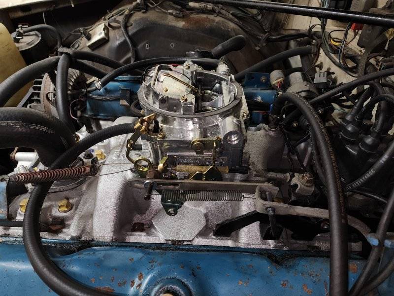

I appreciate the info and response. I will try timing as you mentioned first before removing the distributor for testing. All other degrees failed the ping test. I tested the vacuum pot, it is working and holds vacuum. Regarding the trans kickdown. I will have to get creative as there is no adjustment on this later 1975 edition. Edlebrock sells an adaptor although my issue appears to be the 2bbl clevis rod is too short. Any ideas? Pictures attached of the current set up and the trans slips briefly when shifting into 2nd already. The previous owner had the car this way and may have already ruined the trans. I hope not. Will not be driving again until I fix the kickdown linkage issue.
