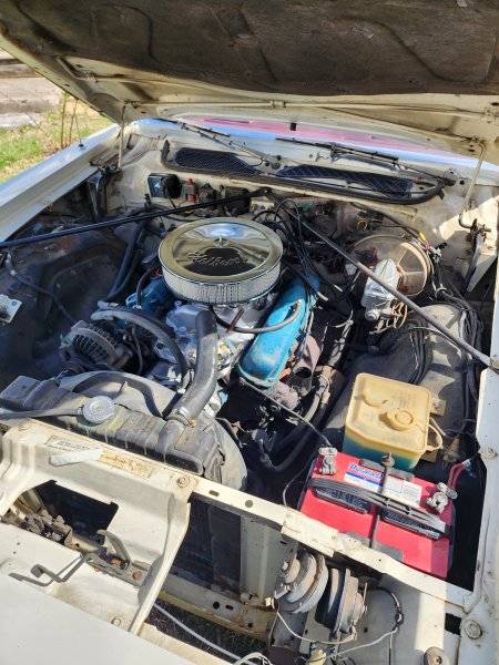

Good day,
The previous owner installed an aftermarket edlebrock air cleaner on the stock 318 engine with a 4 barrel edlebrock carb and intake currently installed. I am looking at a 1974 4 barrel stock snorkel to put on the small 318 motor despite being from a big block motor. Would this fitment look OK and be functional. Size comparison would it consume the small block engine and look bad.
Thanks for the help,
Jon
I've tried the same and the Big Block snorkel factory air cleaners don't clear the distributor/wires.
Also the upper radiator hose.
I had a real nice dual snorkel from a 69 Chrysler thinking man this will look nice.Nope :(
