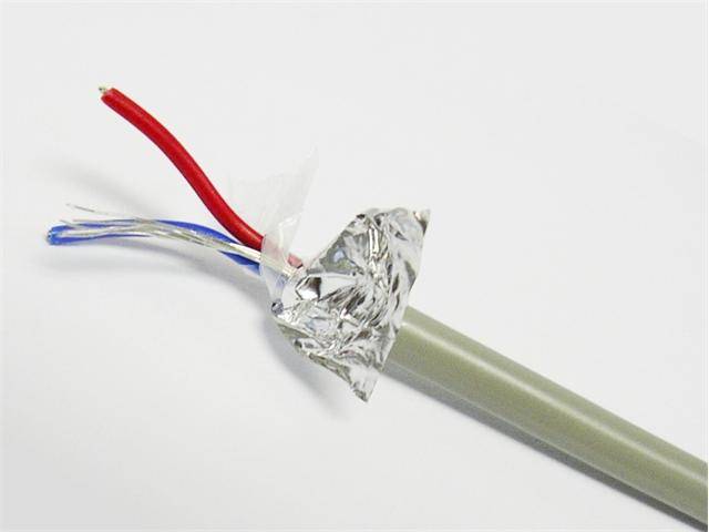

Screened wire - shielded...
You may need to buy a twin (two-core) screened Instrument cable - if no automotive singles are available.
Some cables have a screen as well as a drain wire, the foil is the screen, and the drain is the tinned bare conductor which connects to the ground (earth point)
TV Co-axial cable is an example of screened cable.
