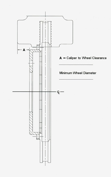

Need some help finding a set of wheels for my 71 GTX. Intent of the car is street driving and autocross in the CAM class. I would like to run a 18 in the rear and a 17 in the front while using diff doctors viper brakes in the front.
While I would like to use the big brakes I can't seem to find a classic looking wheel that has sufficient brake clearance. The wheels I really like are the et classic v or the et lt-iii but only have 1-1/16" clearance. I understand the viper style brakes require 1-1/2" clearance. I don't know if this is correct though.

Honestly, the GEN 2 viper calipers are.. H-U-G-E as Donald would say, I had Dr. Diffs viper kit prior to upgrading to his Stage 4 setup. Do you already have the brakes, if not, I would do some 'soul searching' and go with at least the Stage 3 kit with 13" rotors and Cobra calipers for 17's. I walked out to the garage with my 11.75" rotors, placed them next to my 18" wheels, and instantly put them up for sale. His stage 4 'Brembo' calipers are made by Baers supplier for Ferrari, and take modern Viper pads, so many race-oriented compounds are available (He will ship you whatever pad you would like for your kit for a small upcharge, just let him know prior to ordering). 11.75" rotors look great on 15" wheels, but visually look undersized when you toss on 17's or 18's, especially on a 71' which already is a bit oversized. Just my honest opinion! Can't help you on the vintage wheel choice, as most classic wheels won't accept the viper calipers (has been discussed many times on various forums, even the yearone 17" rallye's won't work).

These wheels fit 05-14 mustangs, so you'll have no issues with caliper clearance or limited availability (could you imagine curb rash on a $1,000 custom wheel?!). They have a positive wheel offset (1.3") with a large amount of backspacing (6.34"). This is unlike anything you'll find 'off the shelf' for a classic Mopar, as most are neutral offset and utilize 4.5-5.5" of backspacing. I run his stage four kit, the 'brembo' calipers are nearly identical in size to the GEN 2 viper setup. I have absolutely no issues with clearance, and obviously, mustang wheels aren't going to have any issue accepting a mustang specific brake caliper (as in his stage 3 kit).
