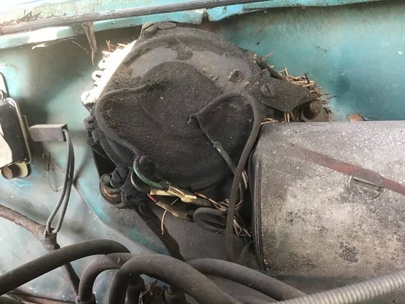

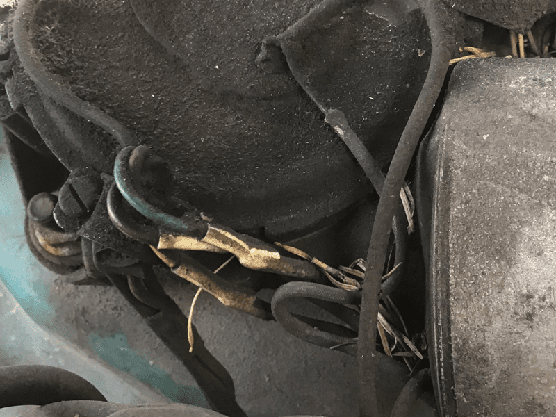

I just took the Charger for a 25 minute round trip to pick up my kid from school and no tick-tocking after unplugging the wiper motor. According to the service manual, the circuit breaker for the wipers is integrated into the switch, which is right above the climate controls and explains the noise as it continuously tripped. It appears that my wiper motor has been fiddled with at some point as all the external wires between the two pieces of the motor body are spliced.
So now I'm apparently pushing back my plans for my next go-faster item (I was planning on doing an Edelbrock Performer RPM manifold next) so I can send off this stupid wiper motor for a rebuild. Can't go fast if you can't see...
Splices are from the factory. Pine needles were added later.
Check the wiring for damage.

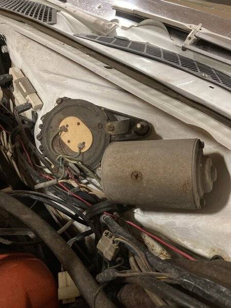

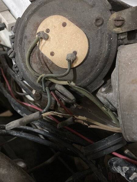

They are the concealed blades. I’m pretty sure the motor is correct but the wipers are sluggish when working. The wiring, as you can see, is pretty much just exposed metal. I’m going to take the whole assembly apart and clean it up. From what I can see, the drive link system appears complete.
