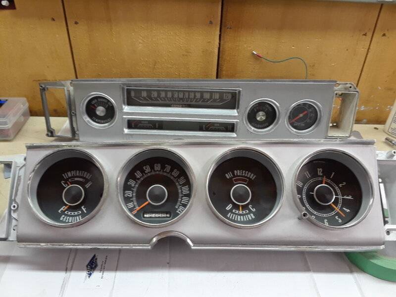

I have a parts car with the Plymouth cluster. There are two 5 pin connectors on the Plymouth cluster printed circuit board and one 8 pin connector on the Dodge. The circuit board on the Dodge is continuous and the Plymouth is split into two parts. For the most part, wires are color coded the same, but there are 2 extra wires on the Plymouth cluster. One of the extras is for gauge lighting - because it' a split circuit board. One wire left to account for. I have wiring schematics for the American Dodge, as well as the American Plymouth. What I really need (I think) is the 1964 Chrysler of Canada service manual (Yellow / tan cover I think). This would offer me a look at a Canadian built schematic of the Plymouth dash. I might be going down a rabbit hole here, but I'm not giving up just yet. Hopefully I won't fry the whole works!

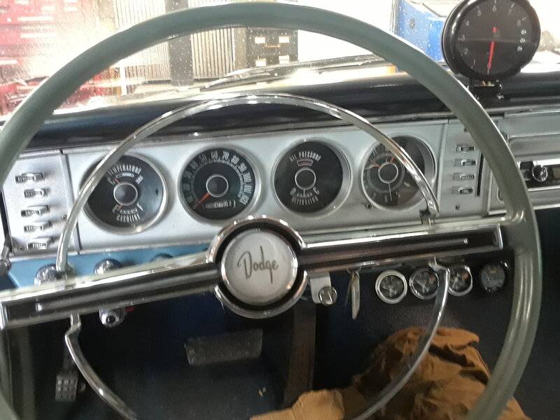

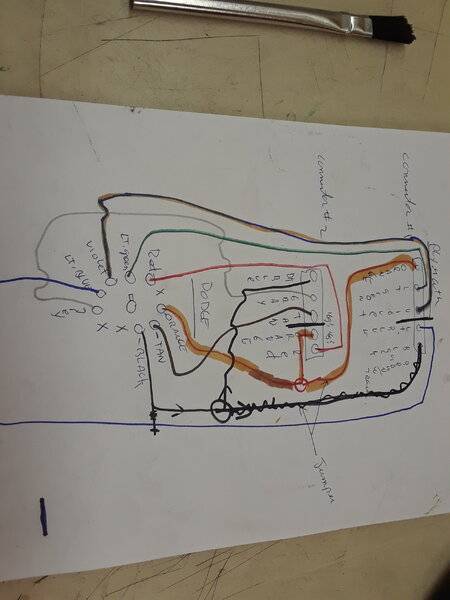

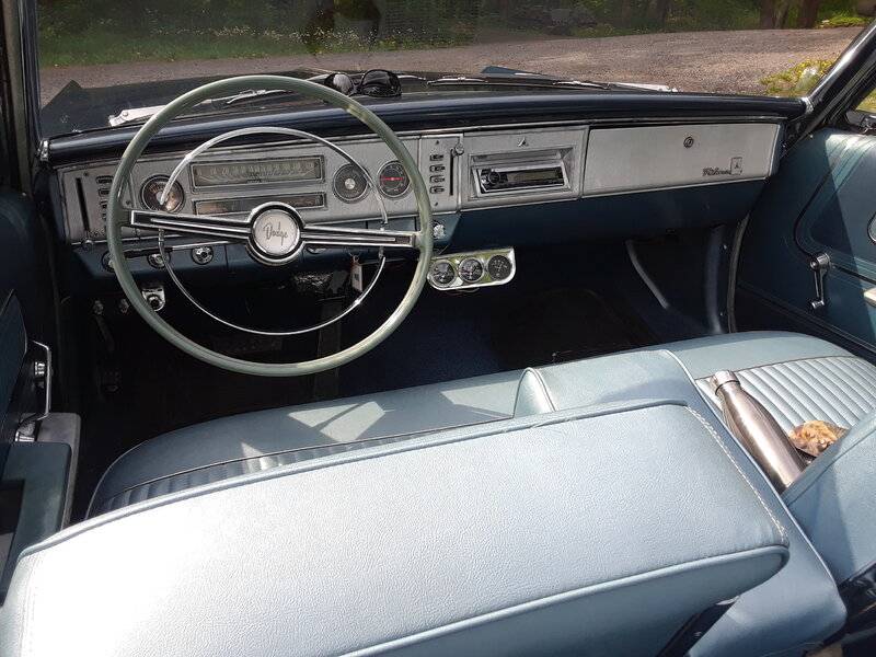

Transplant completed and successful. There were some wiring issues to sort out, but the item that gave me the most problem was grounding. I had to run a direct ground to the new cluster. Photos show before and after. Not everyone would do this swap, but I prefer the look of the Plymouth dash. I was even able to get the clock to work. If anyone is looking for a nice 64 Dodge cluster. with a Year One in dash Tach, complete with all bezels, let me know - it's for sale.

That's really cool Charlie! I am looking to do the same with my 65 Coronet. I love the 64 cluster above all. My parents had a 64 Sport Fury growing up and used to love looking at that cluster. Like its imprinted in my brain. Thanks for including the diagram. Mine being a 65 may not be all that different in wiring, but I know it is in mounting but I'm gonna do it any way I can. Love the look for sure.
