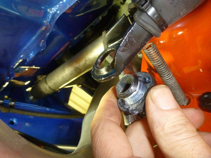

Anyone got a go-by on removal. I’ve spent too much time under my dash lately replacing the master cylinder and pulling/replacing the steering column.
Depress the pedal to the floor which stretches the spring and slide large washers between the coils. Let the pedal back up and the spring will come right off the pivots.
Those super stiff pressure plates are really hard on the clutch linkage, the more slop in the linkage the harder it is to adjust pedal height.

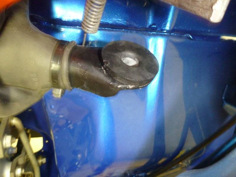

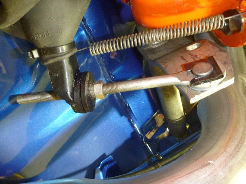

So... you should be able to pull back on the fork, via the washer, so that the throw out bearing hits the pressure plate and have about 3/16" of slop between the washer and the nut. Adjust the nut until you have that "free play".

I bought a 68 charger 4 speed years ago. It had a diaphragm clutch and pedal would stick to the floor, needing an assist with the foot to come up. Found the over center spring, removed it and was 100x better. I no longer want a b&b pressure plate.
69 rr was same way, or maybe I changed that clutch myself from b and b and the spring had to go. Can’t remember. I do know both cars I couldn’t get anything between those coils. Nothing. It’s like the coils didn’t change as the pedal was moved. More like it pivoted on the mount points was all.
So put on the best protection I could and dremeled my way through them. Sounded like a gun blast. I and the cars were unscathed. I recall lining up the blade and getting my head and neck above the area and kinda had my body to the outside of the car. Definitely the most scary work I’ve done on a car.
I can imagine. That's a hefty spring!
So... you should be able to pull back on the fork, via the washer, so that the throw out bearing hits the pressure plate and have about 3/16" of slop between the washer and the nut. Adjust the nut until you have that "free play”

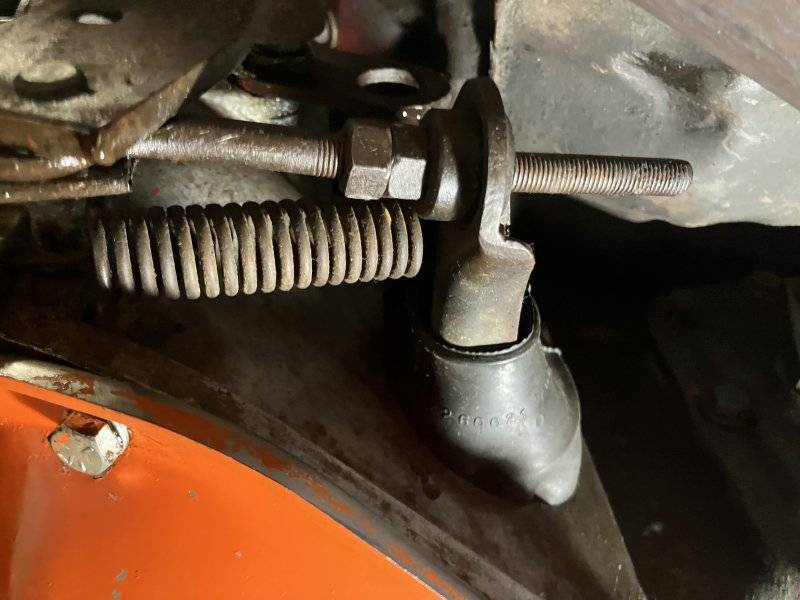

Is this the right? I don’t see where mine has really any space between the washer and the nut? Or do I have to pull back on the fork first to check gap? The spring on mine looks like a heavier gauge? (if that actually means anything)

Spring there should be nothing stronger than what is need to hold the throw out bearing off the pressure plate and keep the fork from rattling. That spring looks mean.. lol. Hold the adjuster rod, pull back on the fork. You should get a gap of about 3/16 or so...
Thanks I’ll check that out again. Btw, is the general amount of existing adjustment left on the rod relate to the amount of clutch wear by chance?
From the pics we posted the adjusting nuts appear generally around the same end of adjusting rod?
If it does relate to clutch wear does that help determine if the clutch engagement on mine (at top of the pedal stroke) may be indicative the existing clutch is not at end of life? clutch wear? Or a matter of adjusting free play first then checking engagement point?
I’m not sure you can speculate based on that. I’d order the oem spring.no wonder it’s so stiff. At least compared to later 60s car spring anyway. I’d not think that one should be much if any different.
No you can't compare adjuster rod settings. Different pressure plates, different set ups, and the picture I showed you can see in that shot that it's not even tightened up yet.
As for "top of pedal", it ain't a truck and dis-engage shouldn't be down at the floor. You should be able to side step a clutch pedal and dis-engage and re-engage a clutch when into it. That's why you don't drive with your foot resting on the pedal, killing the throw out bearing. Even my Wife has that down pat... she's been driving a 4 gear since she was a teenager.
