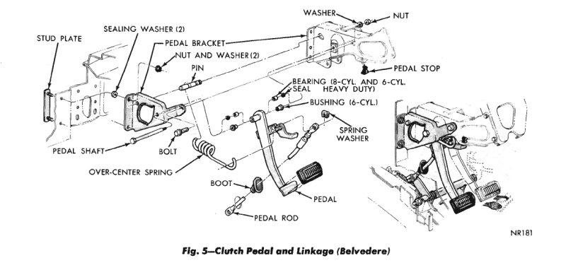

Arrangement underdash:

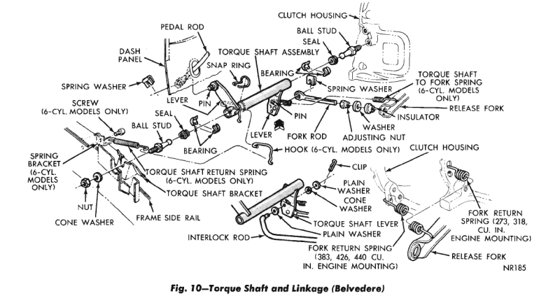

Arrangement Under Car:

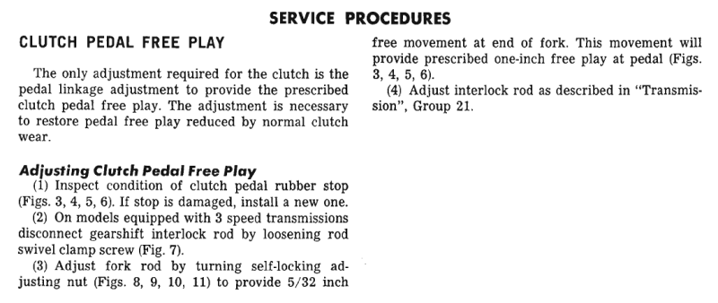

Adjustment Procedure:
(Notice they want that 5/32" measurement at the end of fork - which means it'll be more than that between
the throwout bearing and fingers of the diaphragm.)

First off, all of the pictures need more grease on the pivot points, that will reduce effort. Over the center spring helps you push pedal at higher rpm with original B&B which has rollers/weights to apply more pressure at higher rpm/power levels. It will hold pedal on the floor with a diaphragm clutch at higher rpm, except for maybe a center force clutch which has weights, but I doubt they even do anything other than a gimmick.
That hood spring on the linkage needs removed. If it is put on wrong to a anchor point and then to fork being pushed reward it is adding too much to the effort. The correct way to have that spring is to be a flexible way to keep adjuster, fork and Z bar arm all snug together having no effect on effort. Over center spring other action is to hold pedal tight up against the stop. If it is not present with diaphragm clutch you need to add a very light, long pull spring to pedal and dash/pedal box to keep pedal up tight to stop for consistency.
Lastly the adjustment in picture with the hood spring is almost run out, so something is worn, pivot points, ball stud bushings, pressure plate fingers , clutch plate, something needs replaced. Typically the adjustment is all the way towards the end of the threaded part when new, non worn parts.
It was talked about here with the torque shaft and it's bushings being good, which I agree is a good thing to check.
I've noticed on some new replacement kits, that the springs that locate the bushings don't always line up with them. What's the point of these springs that go on the outside of the torque shaft?
To locate/keep the bushings in place?
Asking out of curiosity and if it's something that can help the OP.
What spring goes on the outside of the torque tube? There is one retainer clip, on the pedal rod side, that locks the bushing in place within the tube.
