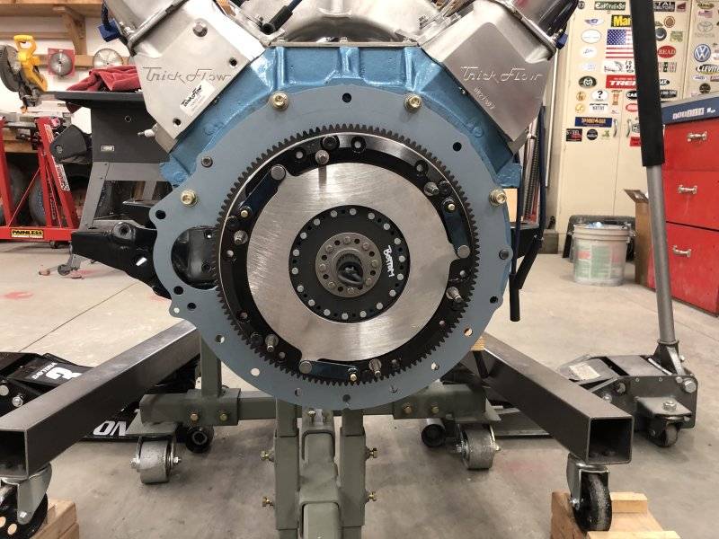

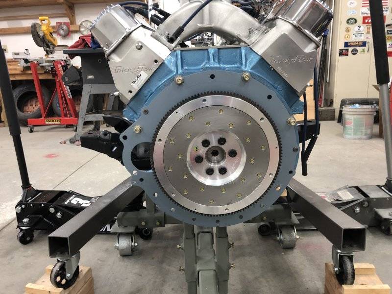

I have had my TKX installed for about 2 years. Having seen a buddy's dashboard, windshield and roof on his 55 Chevy, plus his girlfriend's damaged leg, after his flywheel came apart at speed, I'm a true believer in scattershields. I used a QuickTime steel housing, an SFI approved CenterForce aluminum flywheel and Dual Friction clutch. I had a master/slave hydraulic clutch but opted for a hydraulic throw out bearing to simplify things and open up some real estate in a congested area. I'm 79 years old and the clutch pressure isn't enough to bother me. When you pick your flywheel and bellhousing, see what diameter clutch they will accept. I use the 130 tooth flywheel and 10.4" clutch set; along with 3.91s and M/T 29X15 tires...

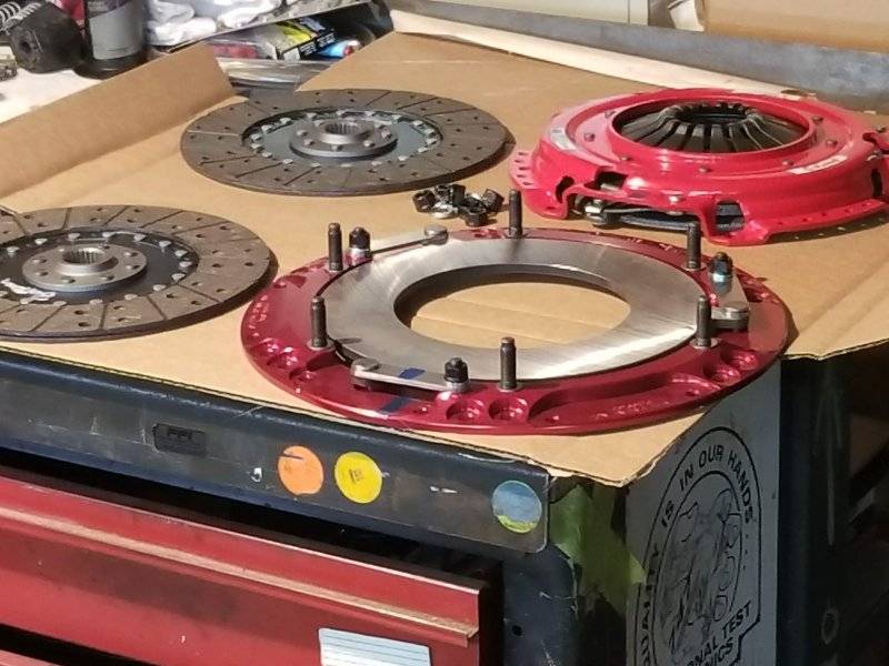

Is a dual disk "really" worth another $1300 over a single disk? Longevity? Precision?
McLeod twin disc is around $800. Got one on my TKX.
McLeod Racing RST Twin Disc Clutch
Got this from SST. 415 RWHP. Easy. Smooth. Nice launch. Street use.

The aluminum flywheel makes sense on a 90% track car...not so much for the street.
Not in AZ anyway..
I was planning to use the AP bellhousing, as is will fit an 833 and the tkx.
I'm curious as to why an aluminum flywheel is state specific?
Light weight and rev positive is good in any state. Street or strip.
