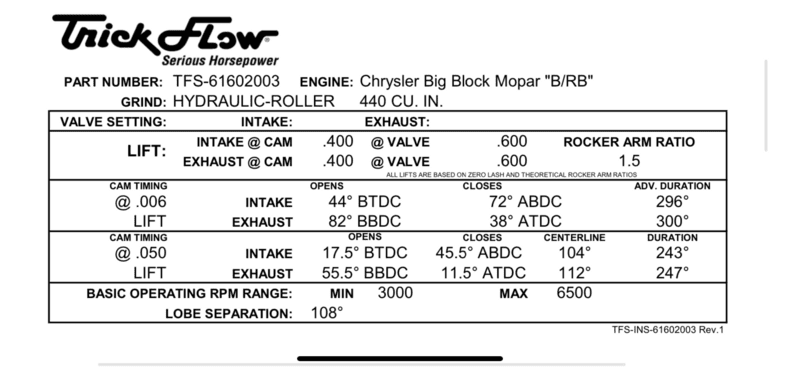

Someone here is selling a new TF hydraulic roller cam with these specs:
So I could go that route with solid roller lifters, or maybe something else? Really not sure...

I like that cam, but I would probably run solid rollers on it, with 1.5 rockers. I don't care for retrofit hydraulic rollers much, I'd run a flat tappet solid first.
I would suggest that you contact Dwayne Porter, PRH here, and get his opinion.
There is also an episode of Engine Masters, where they did exactly that, solid rollers on a hydraulic roller cam. Worked out fine.

Sol roller lifters work fine on hyd cams, done it many times myself. But lash becomes critical, & harder to adjust with alum heads, iron block. If a new cam is to be purchased, why not just get a sol roller?

Be careful using solid roller lifters on a hydraulic roller cam with aluminum heads. The very tight lash requirements mean there will be almost no valve lash on a cold engine and you may even have some valves slightly open on fire up if you are not cautious.
Yeah I've seen that episode, seemed to work without any issues. I also spoke with Trick Flow and Howard's, and they both said that while they can't officially recommend running a solid lifter with a hydraulic cam, there shouldn't be any issues at all.
