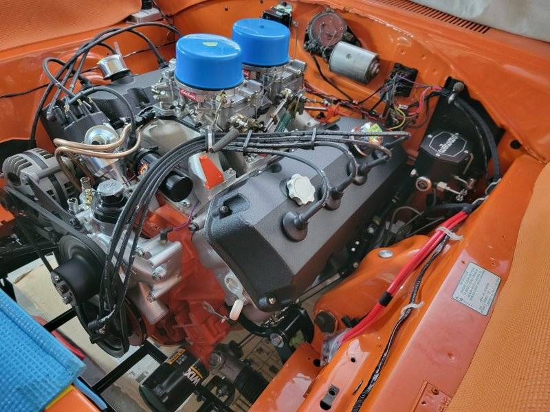

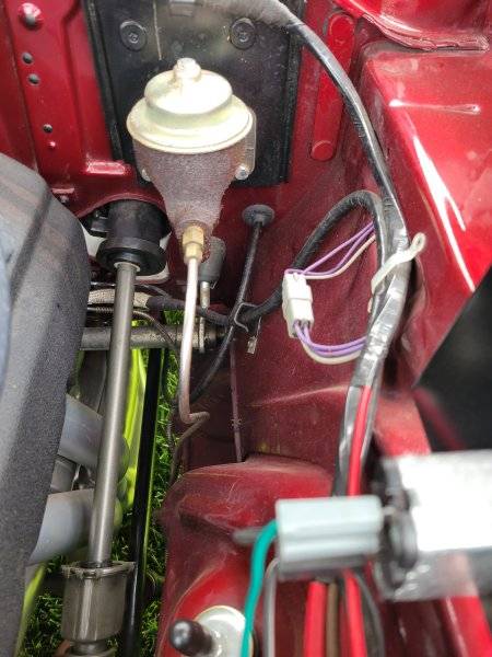

Is this what you are referring to? The black plate behind the master cyl? The orange one is my '69 bird, the red one , not sure what year.
