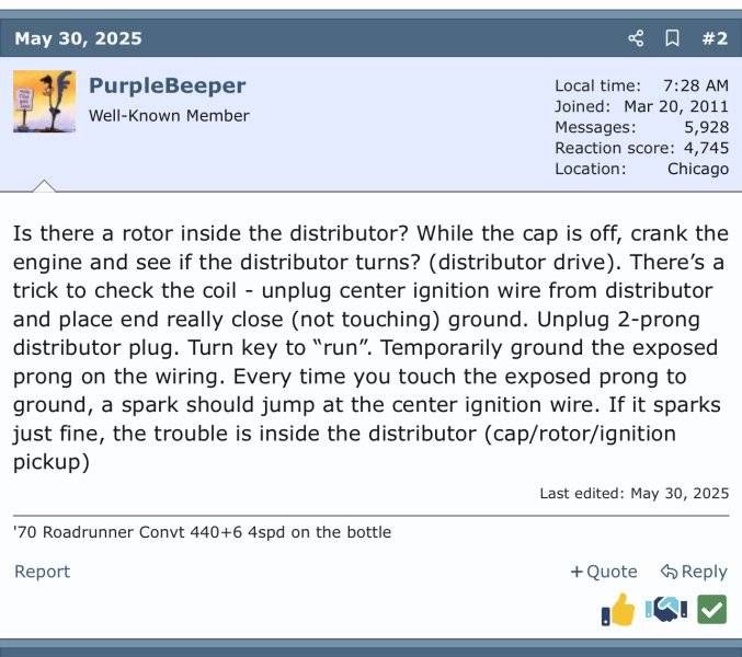

Someone posted about hand spinning the dizzy and that should cause a spark, tried that, but sure doing it right.

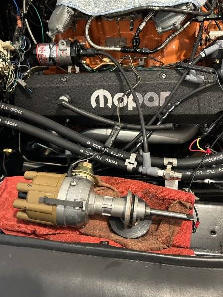

Can the spark testing be done with the dizzy unmounted, like in pic, or does it need to be mounted. Based on certain previous post, it should be able to be tested like this for spark.
Yes, you can test with dist out of the engine. Just spin the dist shaft. Check the p/up coil gap, should be 0.008", in case the dist got 'bumped' & the gap moved.
And the spark testing wire is connected to the coil or the dizzy? At the coil, no spark.
Ugh, while troubleshooting, I read this post 20 times and this morning it finally makes sense. Will try this tonight and see if dizzy problem.
And this test was useless, still no spark, but I can hear buzzing every time I ground the exposed dizzy plug.
