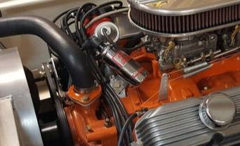

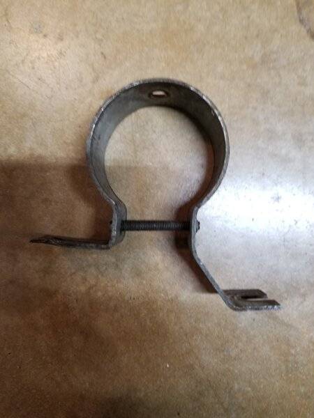

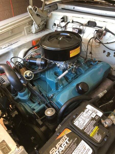

Yes, it's actually a bracket off of a small block application. I have one on my Air Gap manifold just like it. There available if that's what you really want. Do a Goggle search you'll find something. 440'

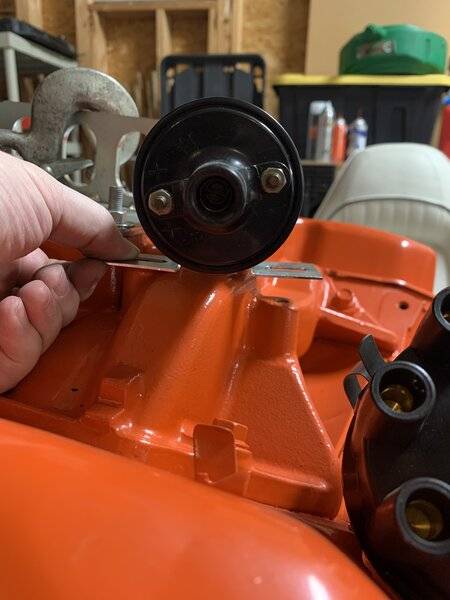

Might be another alternative mounting place. I drilled and tapped a hole in my distributor hold down and used a (chevy) bracket. Factory wiring still reaches. Sorry for the quality of the pic, just changed phones.
