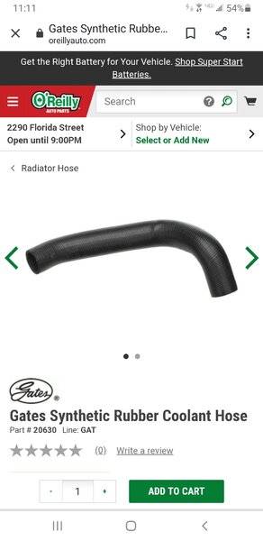

I just asked O'Reilly auto parts to get the one listed by @vance.dykes in the Gates brand. $15 It has the same diameter opening as my water neck, and is 1½" inside diameter on both ends. It looks like the one in the picture.
This is the Gates:
I have so much non-factory correct stuff under the hood, I can't justify paying $58 plus shipping for the Mancini hose, plus the logistics of ordering it through them.
