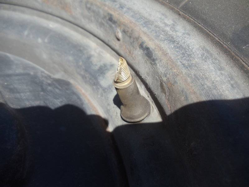

#1) The tire valve on the passenger side tire/rim that was installed backwards was ground down to a 45 degree angle after rubbing on something (perhaps the disc brake rotor?) See foto one:

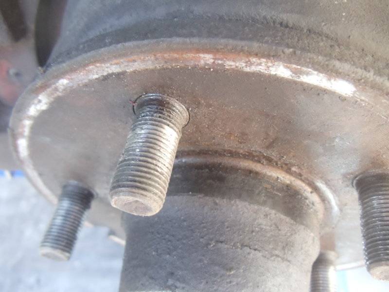

#3) I heard rubbing when the driver's side tire was spun. Removed the driver's side tire. The lugs and lug nuts on this side seem to be semi-stripped (see foto one). Could not remove them by hand. I can turn the driver's side rotor by hand, but it does not spin. I am not sure if that means it is correct or if it is binding.

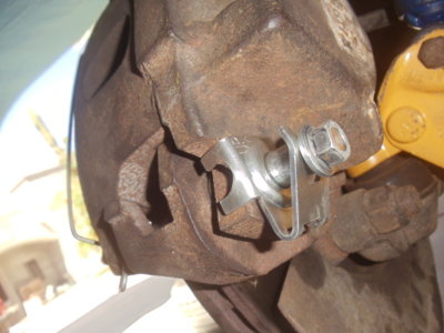

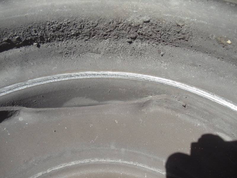

#4) The new anti-rattle retainer for the disc pads is broken off and was rubbing on the inner tire rim (see fotos one and two). I don't know why there was interference there. I'm not sure how the factory installed those.

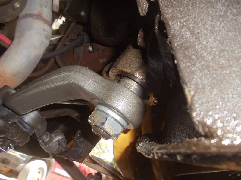

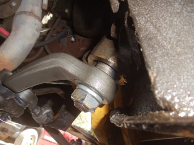

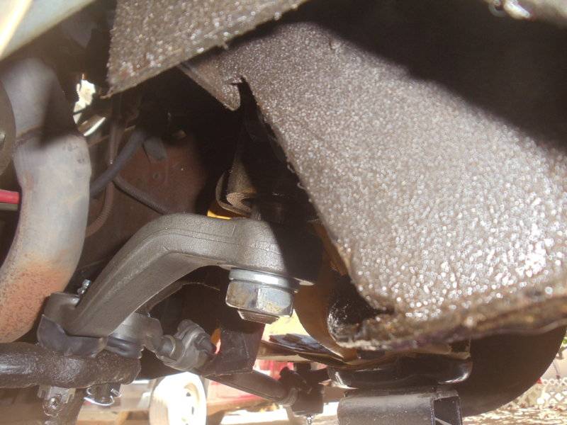

#5) I am not sure if the new pitman arm is installed/pressed on all the way. I see a space between the arm and the frame. (see fotos one, two, three)

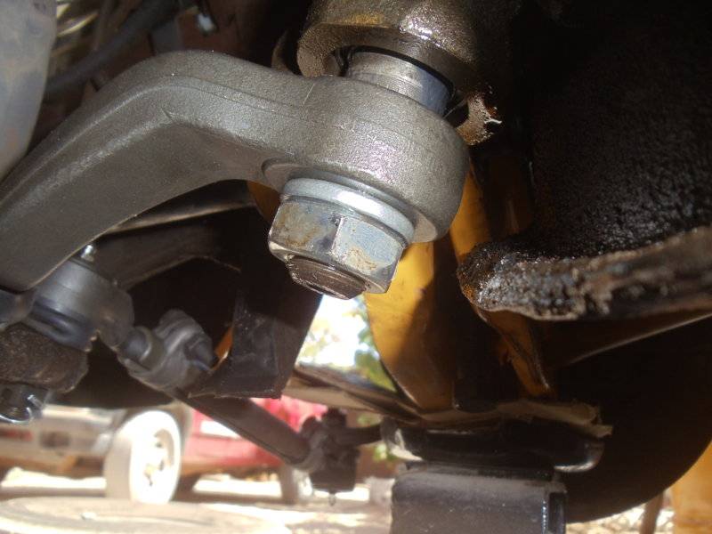

#6) The idler arm looks like it is on all the way, right? (see foto four)

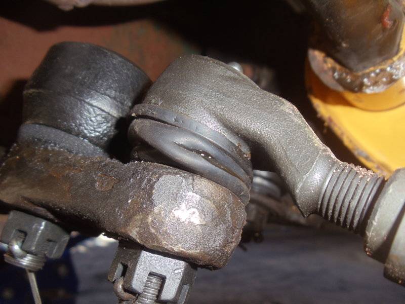

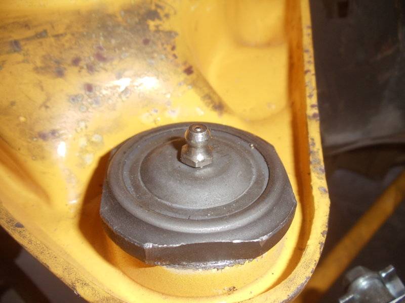

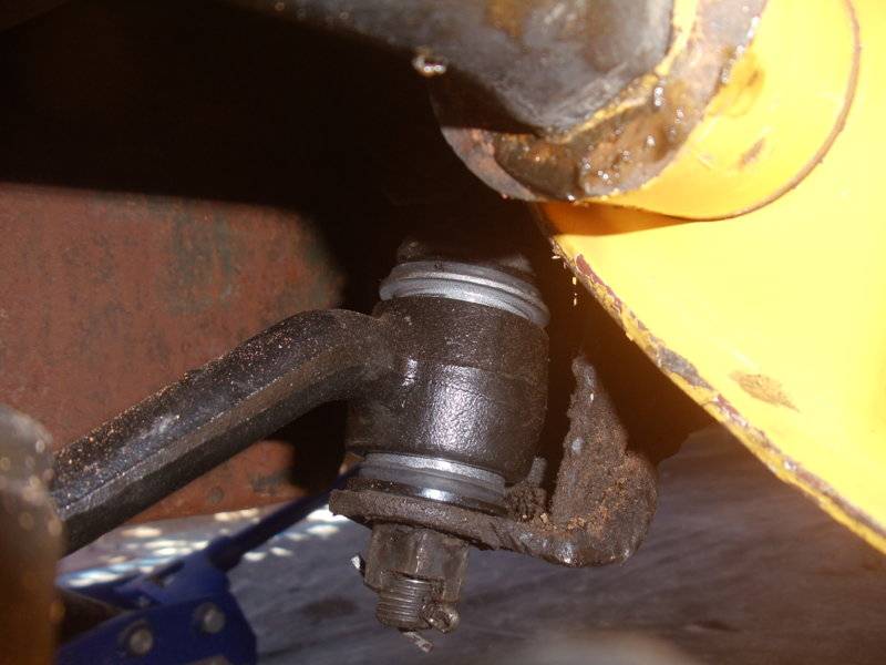

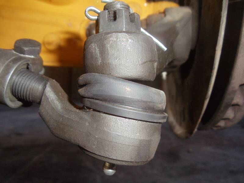

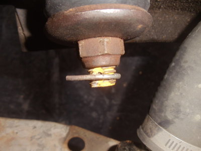

#7) I see a few grease fittings here and there, but has anything been greased yet? (see four fotos)
tie rod end no grease 2.JPG tire rod end no grease.JPG upper ball joing no grease 2.JPG upper ball no grease.JPG

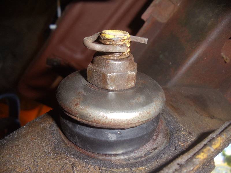

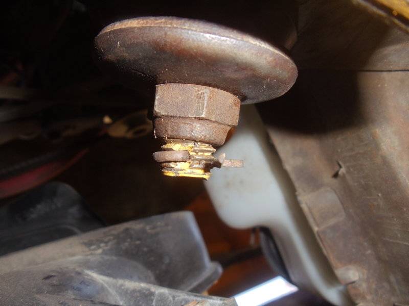

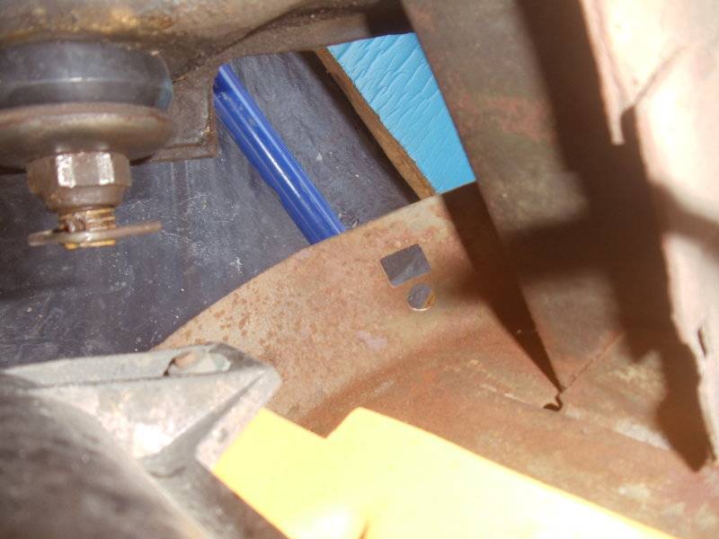

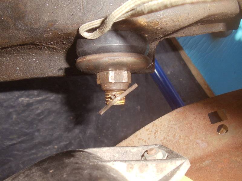

#8) I can't figure out how the cotter pins in the strut rods were inserted, I know they feel loose and I can jiggle them all around. (see five fotos)
strut cotter 1.JPG strut cotter 2.JPG strut cotter 3.JPG Strut cotter 4.JPG strut cotter 5.JPG

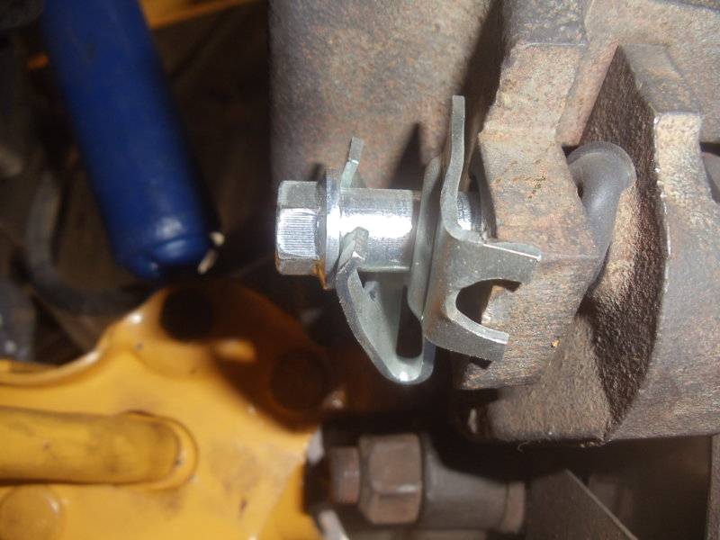

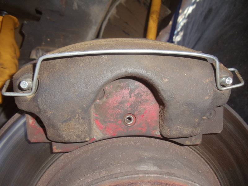

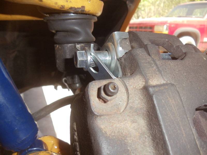

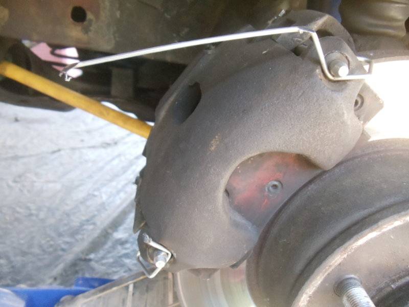

#9) I don't have a clue regarding the disc pad anti-rattle clips, installed correctly or not? I notice in foto three the word "up" on the tab, but don't know what the reference point is. (see five fotos)

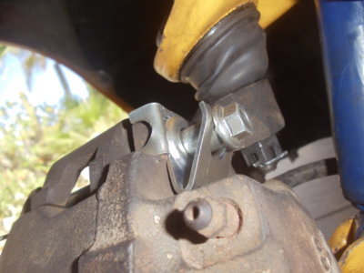

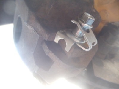

#10) The anti-rattle clip on the passenger side did not break off like on the driver's side yet, but maybe only because the rim/tire where installed with the valve stem on the inside? Don't know if it will rub when I install the rim/tire correctly. (see foto six)
pass inside tab 1.JPG pass inside tab 2.JPG pass inside tab 3.JPG Drivers insdie tab 1.JPG drivers inside tab 2.JPG pass side pad tab.JPG
The splines on the steering box shaft do not go all the way up to the case. The Pitman arm slides to the end of the splines and because of that, there will be a gap.
The strut rods should have had a roll pin in the end but I have not put them back in every time with every car that I have done.
The wheel mounted backwards is a real slacker move! It was the brake caliper that the valve stem was hitting, most likely.

Get your car out of there, and don't go back. From the pics you provided, who knows what else they did incorrectly. The rubber boots definitely have no grease in them. The cotter pins do not look right for some reason.
Pull every cotter pin, and check the torque on every fastener, and grease everything. I don't use any anti rattle clips on pin style calipers. I also don't use those positioners on the pins, but you need the double sided rubber bushings in the caliper to omit them. In any case they are mounted all cockeyed
Your calipers have to come off and be sorted out. Pins not tight,bushing f'd up etc. A brake failure waiting to happen.

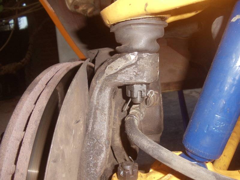

Re: the last foto in post #7 which shows the anti-rattle spring installed, that spring is upside down, causing it to rub on the inside of the tire rim?

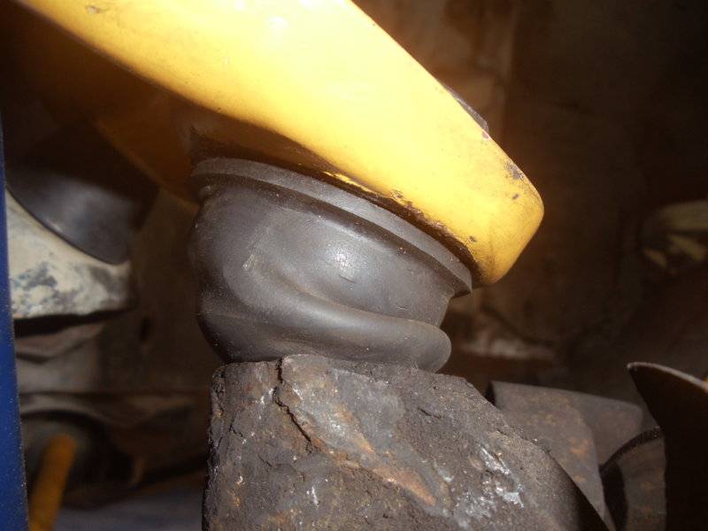

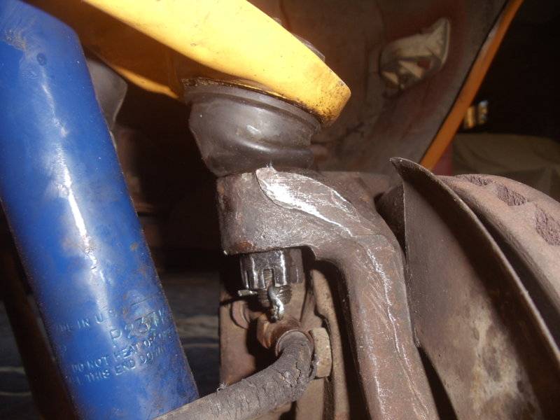

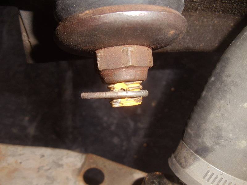

I'm not trying to bust your balls here, but I wouldn't trust that **** for 3 blocks. these front ends are about the easiest job on the planet to do. that picture showing the upper ball joint going into the spindle looks freaking cracked and split. I can't believe someone would be so stupid to put a tire on inside out. and to think you actually paid some idiot to do that is just mind boggling. I would HIGHLY suggest you figure it out and TEACH YOURSELF how to do this stuff before someone or you get killed. don't take any of this personal, but I would be scared to death to ride in your car lol, in fact, I would walk lol

Well, in my own defense, the alignment guy seemed to know what he's doing when I met with him last month, but they put a bunch of flunkies to work on my car while the alignment guy was doing everyone else's vehicle correctly.
You mean in this foto?
