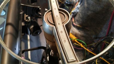

I need the steering column mount at the fire wall... Is this different with floor shift or column shift? I need the floor shift if it is different. Also how does the horn ring come off a Coronet 500? I swore it just twisted off, but it won't budge. Thanks, Jim
Center cap prys,
off then three screws hold ring to steering wheel.
I believe the plate at the bottom is the same. the cap on the horn ring twists off exposing the mounting screws.
No cap... Here is what it looks like. tmp_29911-20160104_115254_HDR-658780892.jpg
It does twist off. I did mine because it was upside down.
I thought it did... I'll give it hell. Thanks!! If I break it anyone know where I can get a new horn ring?
It's off and in one piece. Also found my firewall mounting plate. Thank You, for the info!!
