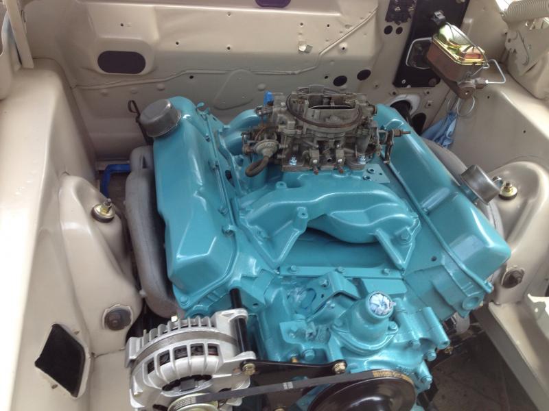

Sorry I don't have the answer for you but I would like to see the rest of the engine bay :)
Sure! Here's where I am so far.

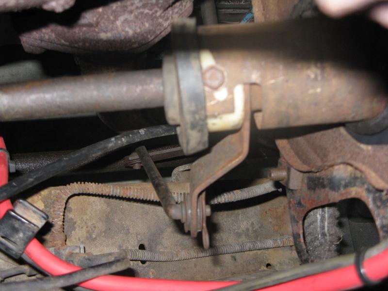

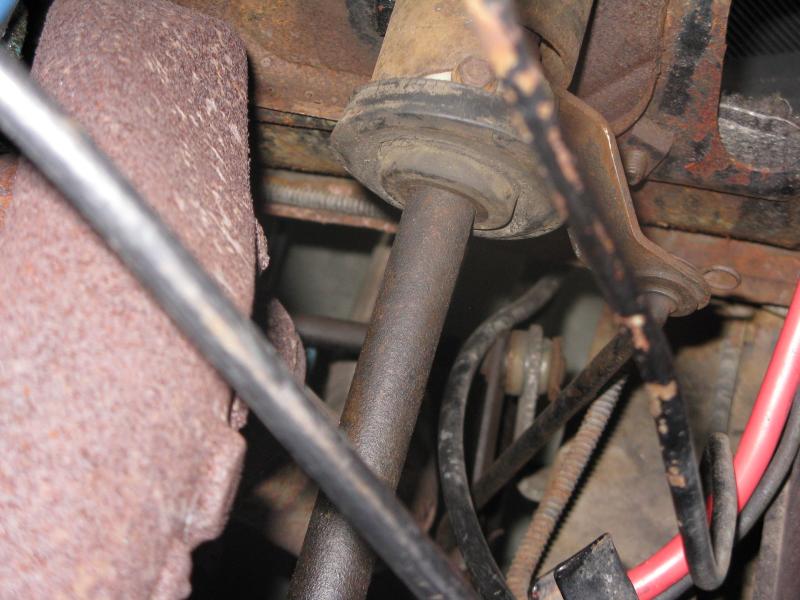

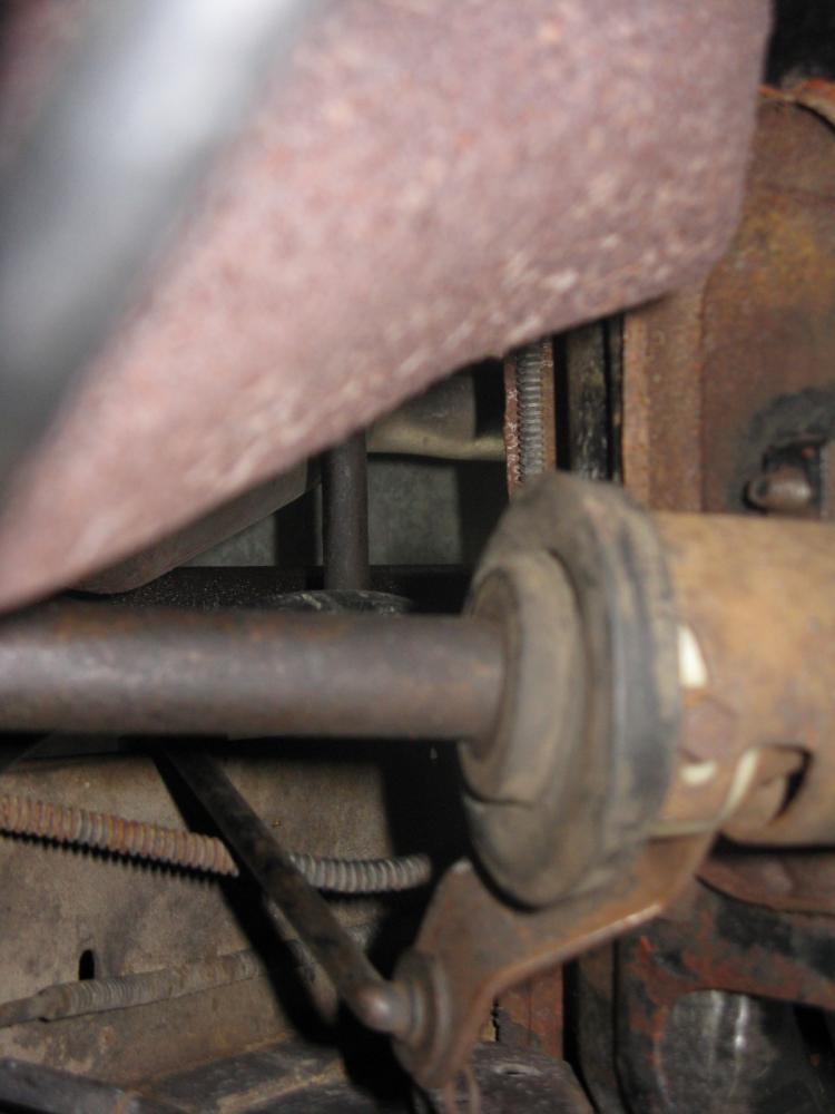

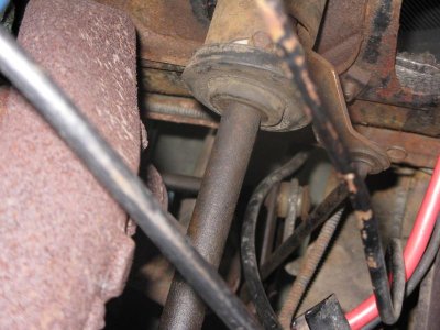

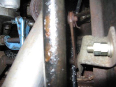

Hey Hosehead, what you need is column shift linkage from a 66-70 b-body,you will have to drill a hole through the frame rail for the outer support. i know this because i have the same set-up in my 65 Belvy. i,m changing to 4-spd so i will be selling all of this but don't know when,soon i hope.i also will be selling all of the kick-down linkage that i have,if your interested. i will try to get you some pic's. John

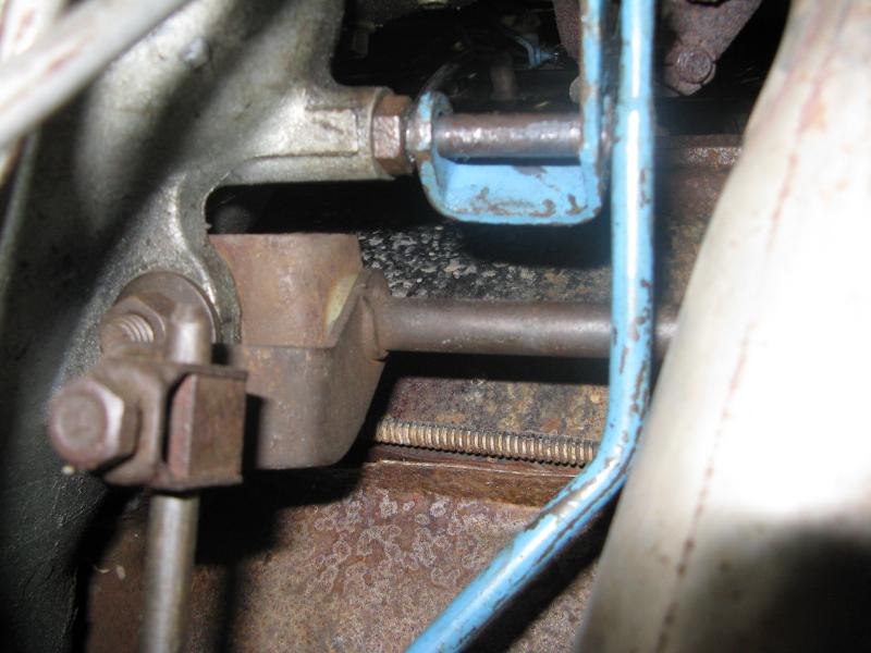

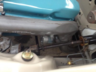

Hosehead! I have did this same swap in my 65 Coronet wagon with a 440 & 70's BB727. I took the
steercolumn from a 66 Coronet w/318 auto. You need the crossbar linkage that came with 66 dodge.
Then I had to modify the bracket to bolt to frame rail of your 65'. Your wiring the 66 column plugs directly
into your 65 harness. The hard part is the modifying the bracket to bolt to the frame rail. We had to
mock it up with my dummy 440 block. It does work nice. I will send a couple of photos as mine is now
finished with motor and 65 bb exhaust manifolds. Will try and send photos tomarrow D.Dog
Awesome! You guys rule! Thanks for the photos John and d.dog!!
