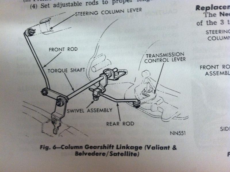

Please take a look at the attached photo from the Factory Service Manual. This is a diagram of the column shift linkage for (among other things) a 1970 Roadrunner. You'll note that there is a Torque Shaft which runs parallel to the ground and rotates between two bushings - one attached to a bracket on the frame rail and the other on a bracket at the transmission itself. On my car, the bushing which supports the shaft where it rotates at the transmission is gone, broken, missing... As a result, the shaft wobbles, and the whole shift mechanism is inaccurate. Any idea what these bushings may be called or where I may find replacements?

Aha. For anyone who needs it:
Mancini Racing: Part # MRE-HF420
Gearshift Control Torque Bracket / Bushing: Gearshift Control Torque Shaft Bushing
$6.95 Buy two
