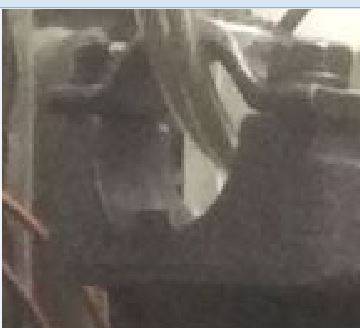

Cup size on 1330 is 1.0625 and is 3 5/8 wide. The yoke for a 1330 has two small tabs on outside of where cups mount. Note tab where cup mounts. If no tab on yoke pot a pic of yoke measure diameter of
cup.
Cup size on 1330 is 1.0625 and is 3 5/8 wide. The yoke for a 1330 has two small tabs on outside of where cups mount. Note tab where cup mounts. If no tab on yoke pot a pic of yoke measure diameter of View attachment 911114 cup.View attachment 911114
