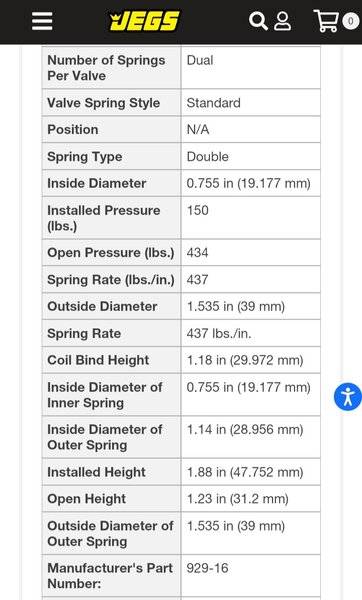

Do these specs show anymore on Jegs add?
https://www.jegs.com/i/COMP-Cams/249/929-16/10002/-1

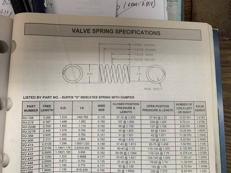

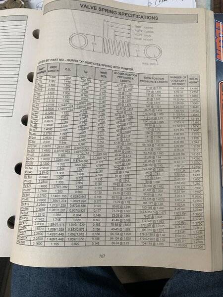

The "Free Length" is the measurement of the spring, uninstalled and sitting on the bench.
Using the pressure @ 1.850" installed height and the spring rates in the Comp Cams catalog, the free length of the 929 will be approximately 2.206" and the 928 will be approximately 2.333".
NOPE, that is not going to work as they are dual springs. I just tried those calculations on a 925 dual spring and got 2.181" and then measured the spring at 2.430". It would work if they were single springs.
