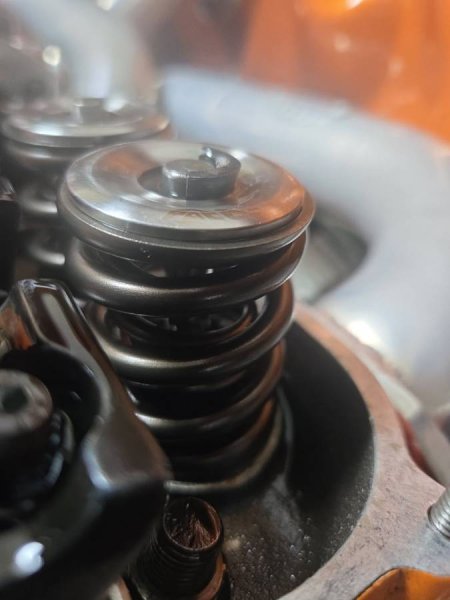

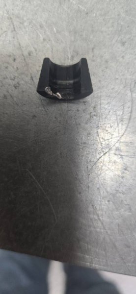

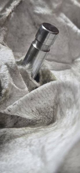

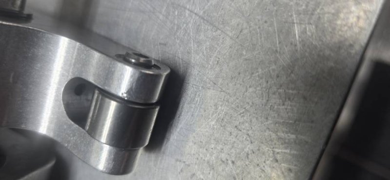

Wasn't happy about chalking up an 003 R/T loss last week. Until today. While running the valves today #1 exhaust didn't feel right. New rockers the roller spun ok. Im thinking whats sticking up under the wheel?. Pulled the pair off. There staring at me is one valve lock about 1/2 way up. Pulled the spring. Valve, retainer and rocker have no damage. I must have burred the lock when swapping springs to start the season. 17 passes since the swap. Good to go for this weekend. Thank you God.

Being nosey and curious- what would have happened because of that?
The valve would drop down into the cylinder and at minimum destroy the piston and make the head need welding and a lot of work.. and the time it would take would be worse than the money. Worst case would be literally destroying the block/motor.. or at least needing a sleeve. That right there is about as close as you get to disaster and avoid it.. an amazing catch :)

Did you replace the keeper looks like the burr chewed up pretty good.
Are those Super 7s or 10° locks? I assume it is a 11/32 steel valve?
Nice catch! That could have been catastrophic.
10 degree Pac machined locks. Ferrea 11/32 stainless valves. Yes new locks.
