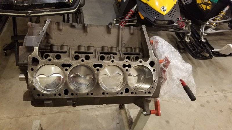

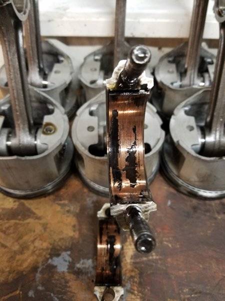

So the back story. Last fall I lost 2 rod bearings on my 440. I have a fresh 512 stroker getting ready to go in.
My intent was to reuse my cam and hydraulic lifters for now. They appear to be fine, no wear on anything. Is there any concern about debris in the lifters themselves? Hate to put this together and have problems. The budget is tight, because we are building a new house too.

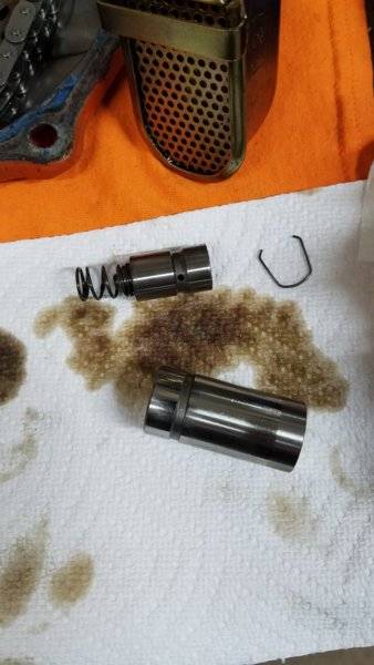

If you are worried about debris inside just pop them apart one by one, clean and reassemble. That way you have piece of mind. Its not hard just time consuming

Just like normal, I spend a couple hours pondering. For what turns out to be a 45 minute job to disassemble, clean, and reassemble 16 lifters. Thanks again guys. Until next time
Did you ever figure out why you lost the rod bearings? I think that would be the important part to the puzzle.
Original bottom end of an unknown motor. Bought it used, but the accessories were worth 3x what I paid. I rolled the dice and got 1 season out of it.
