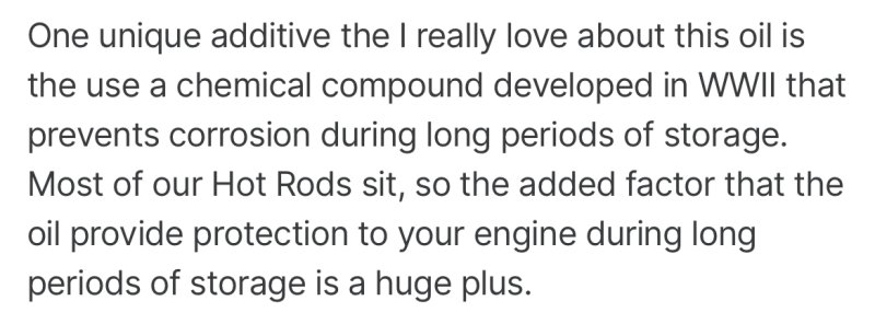

I do not like those Comp roller lifters. Should have used Howard’s for your roller lifters but that’s neither here or there. Heres some literature. Even though it’s a roller motor, which is what I have also. I used Driven break in oil. At the current time I have 15 50 in it but I’m making the switch to Conventional 10 40 Driven. I would run 10/40.
