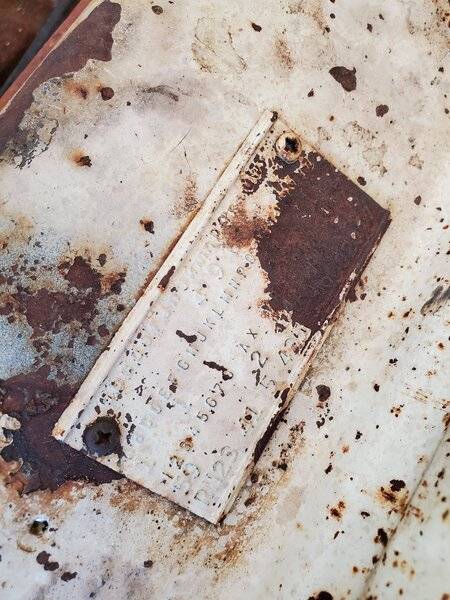

Between having the complete car in what appeared to be unmolested condition and decoding the fender tag a couple of different ways, I thought I had figured everything out about my 67 Belvedere II.
It seems she may still have some mysteries up her sleeves though and I am wondering if anyone else gets something I am missing from the fender tag.
I had to use a pencil with paper against the tag to make sure I was reading it correctly (see images) and checked what I had against multiple sites/tools.
I "thought" it confirmed 1967 Belvedere II with 318 LA, factory AC, 727 auto trans, 8-3/4 with 2.96 wide open, with car in white. The interior color is confusing as the tag seemed to say grey, but it's two-tone silver/blue. The tag also mentioned black striping on the paint somewhere, but I don't see any.
It has the lower trim/moulding instead of the usual higher trim/moulding. I have also found what appears to be DD-1 "light blue poly" paint under the transmission brace/mount under the car, inside of the trunk, and under the headliner inside the car. So, I am not sure what to make of the colors and/or trim options.
The lower trim/moulding seems to suggest that the car had a different trim option than normal, but I don't know what that might be.
Anyone out there able to tell exactly what I should have?

Well... Per input from some old schoolers on Facebook, I guess I have a "silver special". I had no idea... I guess that's what the H4A fender tag code denotes. And... What I thought was a faded blue is apparently a gray/charcoal in the interior color. So, it's two-tone silver/charcoal. That also makes the interior color on the fender tag make sense. I'm sort of an idiot... I was going back and forth about possible color changes because I couldn't stand the idea of white with silver/blue interior. I would've messed the whole thing up!
Now you know. I tried to expand the picture of your fender tag to verify the WW1 paint code. I can't make it out there. What you were describing was a Silver Special to me, but I couldn't find my Mopar Red Book, to look up the codes. Don't mess it up. :)

As Jerry mentioned, I am restoring a '67 Silver Special Belvedere. My tag has much of the same info mentioned previously including:
j4 = body sill mouldings
m9 = delete body side mouldings
Y5= silver vinyl top
TRM = H4A = Silver Special interior
PNT = AA1 silver poly
SB = black stripe
