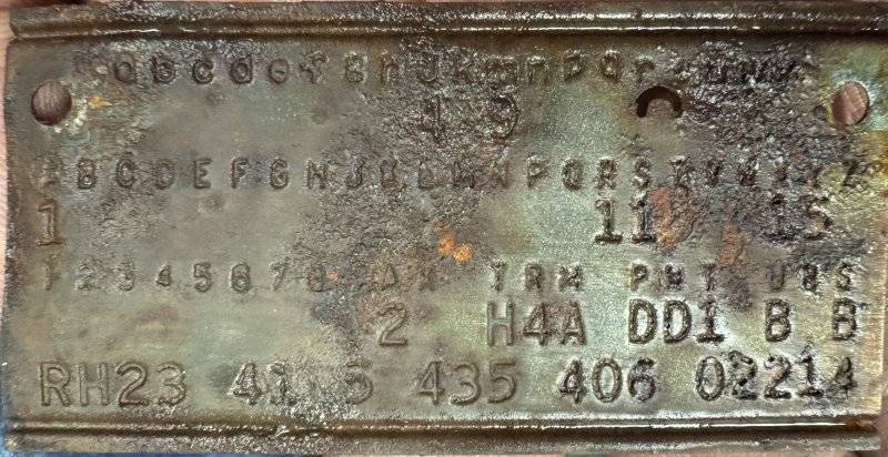

I just got this Belvedere and am trying to figure out the fender tag, i have a lot of it but it is conflicting rear ends (3.55 and 3.23) , Also says rear window defogger?? There is none and it seems to be the factory rear window. Any help would be great
Here's what I got from an online decoder
CAR: Plymouth Belvedere 2 Door Hardtop
ENGINE: 318cid 2-bbl V8
TRANSMISSION: 3-Speed Automatic
TIRES: 7.75 x 14 WSW
MODEL YEAR: 1967
BUILD DATE: April 06.
AXLE: 2.94 Rear Axle Ratio
INTERIOR: High Trim Grade, Vinyl Split Bench Seats. Gray Interior.
PAINT: Light Blue Metallic (Dodge, Plymouth), Crystal Blue Metallic (Chrysler), Wedgewood Blue Metallic (Imperial).
OTHER: Black (Dodge, Plymouth), Formal Black (Chrysler, Imperial) Upper Door Frame Color. Black Horizontal Accent Stripe.

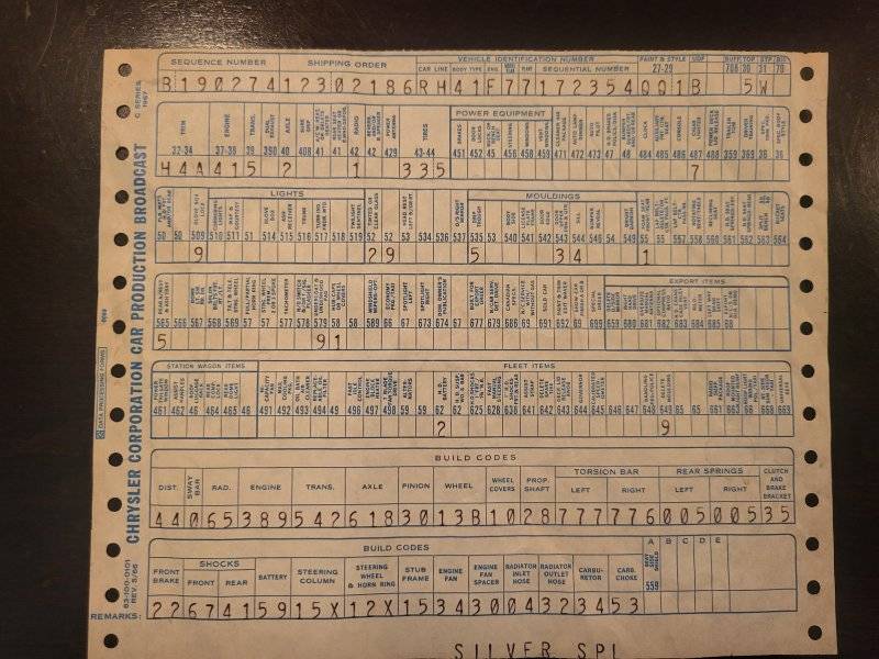

I have the broadcast sheet from a 67 Belv II 4-dr that was an extra in one of my cars. Has the H4A interior code and is stamped SILVER SPL at the bottom. Box 649 - Delete Molding has a 9 in it so I am guessing this corresponds to m9 on the fender tag. Never really looked at that before.
I found a remnant of the BS in that parts car.
Just a few inches of the bottom, with that same SILVER SPL on it.

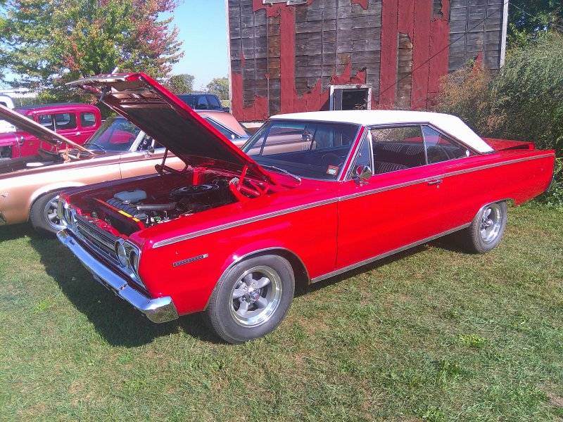

My friend, Ross, has a 1967 Belvedere II that has the high mounted normal bright trim, as well as the GTX-style lower trim. This car is not a Silver Special. His previous '67 Belvedere was a Silver Special car, with the unique interior trim and matching vinyl top. It had the lower trim package.
Yes I have seen them with both kinds of the body side trims also. Oddity.
