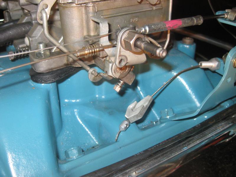

I am using a Lokar cable for the transmission kickdown. I previously had an aftermarket Holley carburetor which had a special bracket for use with the Lokar. I've since switched carbs to a more correct Carter and need to attach the kickdown cable.
I went on the Summit Racing website to see if Lokar makes something for it but didn't find what I need. Any suggestions?

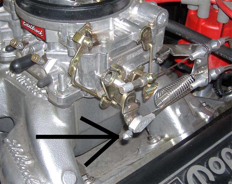

Here is an Edelbrock setup, maybe check their website or google "lokar 727 kickdown" for ideas. You might be able to make a simple bracket that screws to your linkage to connect the kickdown cable.
