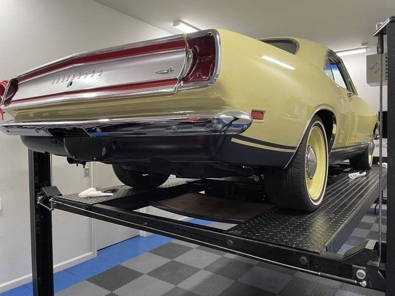

This week, I'm going to mock up one side with black construction paper and an electrical tape stripe to see how it looks on this car.

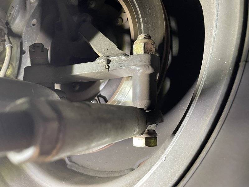

Here's the reason for 17" wheels. I don't know if it's kosher to shorten that spacer .....

If you shorten that spacer it would angle that tie rod upward toward the end. That could create a bump-steer condition as the car goes down the road.
Ideally you want your tie rods level as can be at ride height to keep the distance lost during its travel arc as low as possible. There’s a lot more to it than that too, control arm travel and such but that’s the condensed reason.

Got the lower body treatment done. Got to locate a pair of Cuda hood scoops so I can get the stripes on the hood.
