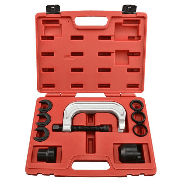

NEIKO TOOL PN 20718A PURCHASED FROM TOOLSANDMORE.US COST $92.41 for 3 day shipping
Plan to attempt to replace bushings on my 74 charger with this tool. I will pass along my results
I'd think the grooves cut in are meant to go around the bar so that kit might work did you buy that or do places rent that one out.
Please let us know if that works.
I couldn't see a way, but I didn't have it in hand.
I did have a new to me press and the bar stock pictured, although I did have to buy the pipe sections, which worked great.
