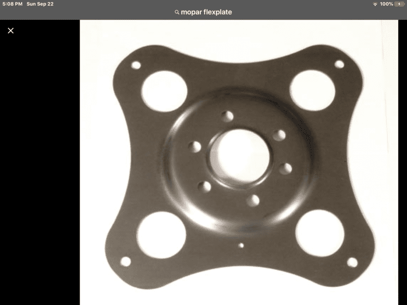

Picture shows a standard Mopar flexplate... See the little hole at 6 o’clock? That goes 180 degrees opposite the drain plug....

No, ended up hogging out a couple holes, got 3 bolts in, 4th is too far off. Just saw the post above about the small hole/drain plug , good to know! I just need to be able to move the car, once I got it running /moving I'll try lining up using the little hole.
