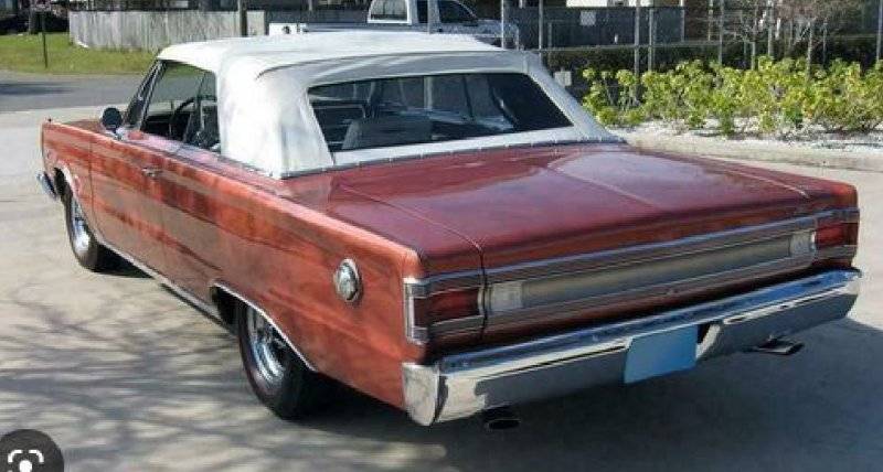

Like I mentioned above E bodies were always glass for the factory & I can't be 100% certain on B bodies but in late 65 my cousin bought a new 66 Satellite Vert & it was glass...
The rear bow was changed taller in 67 for glass window. My 66 plastic. Asked for glass window top guy told me about the rear bow.
I knew E-Bodies were glass. Just could not remember on the B-Bodies. I had a lot of Oldsmobiles and Chevys back from the early 60's that were plastic. The mopars I had were parts cars so I never used them. So for the poster if plastic I would un-zip it and if glass from what others have said let it drop with the top.
Who ever "stretched" that top needs to do it again....
Wish I had a 66 & 67 parts manual..... I'd like to verify that rear bow part number... I know my cousin Ed's Satellite had a glass rear window... I would almost swear it was a 66 since he got it soon after he returned home from an adventure in SE Asia... But he might have kept his 64 Sport Fury a little longer than I thought....
