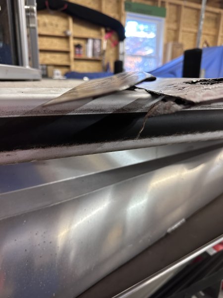

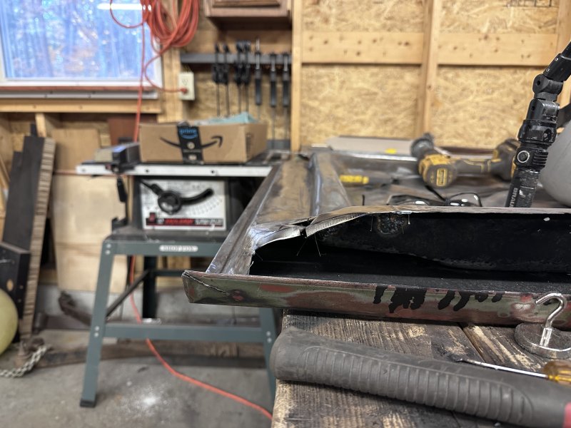

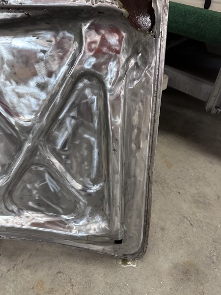

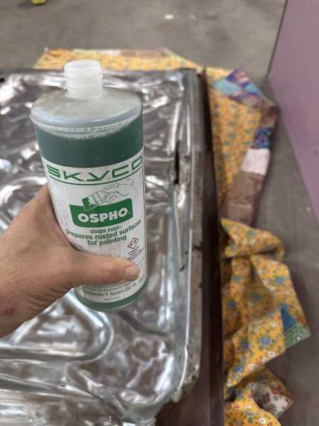

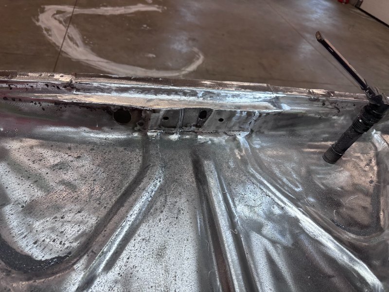

Continuing. I poured some a couple of cups of OSPHO into the lid and sloshed it around to cover the rusted inside:

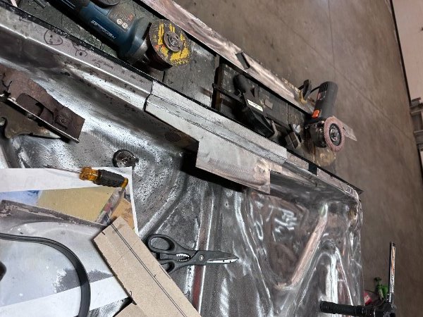

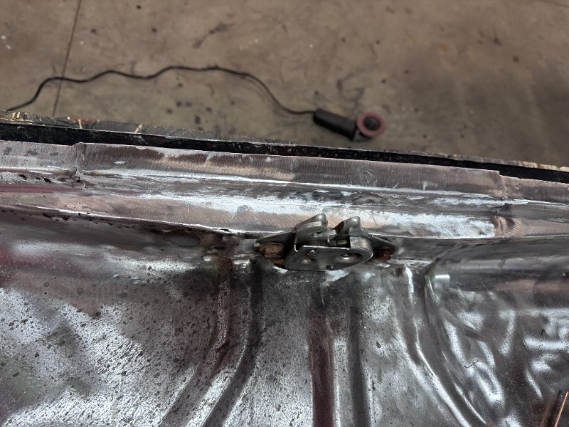

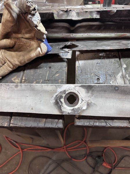

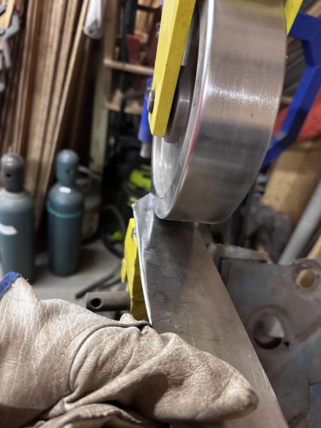

I used my English wheel to add a bit of concave to the tail panel:

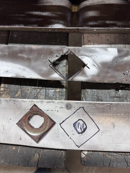

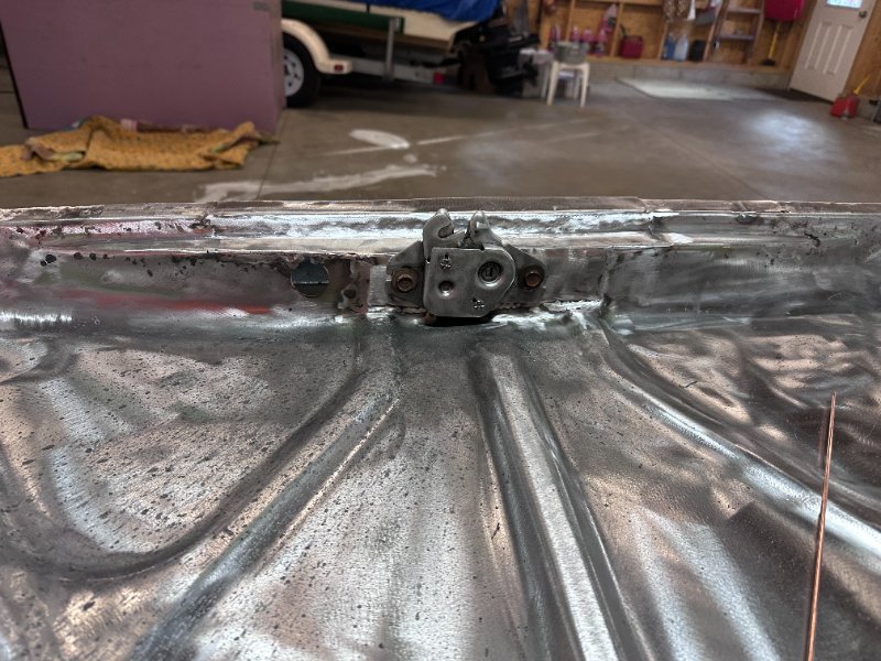

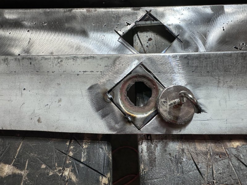

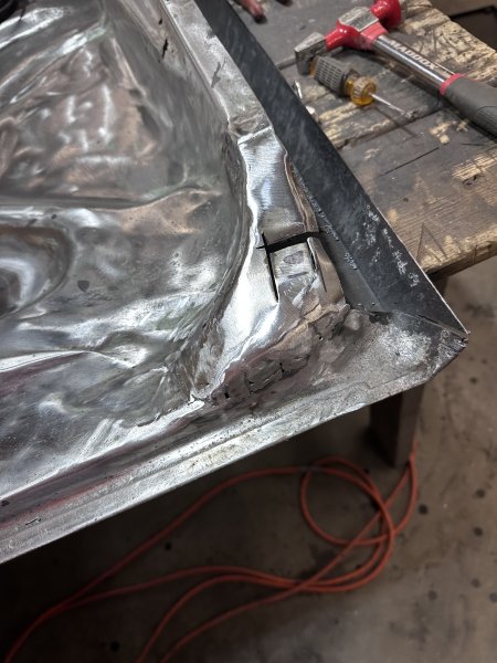

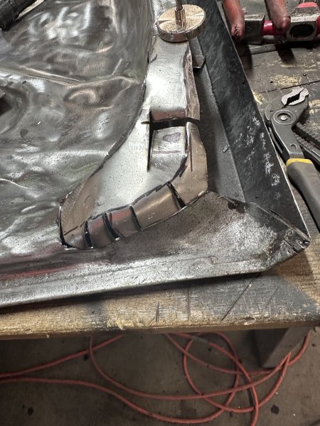

I cut the keyhole from the old panel and welded it into the replacement panel:

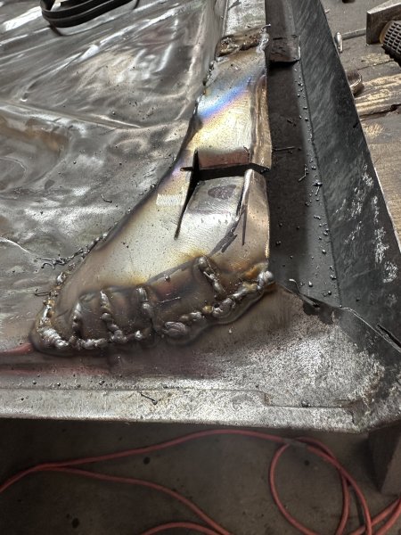

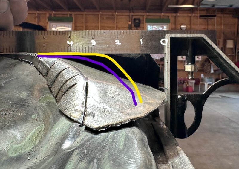

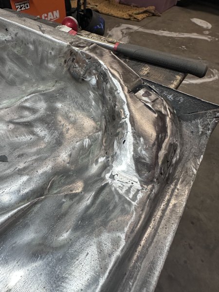

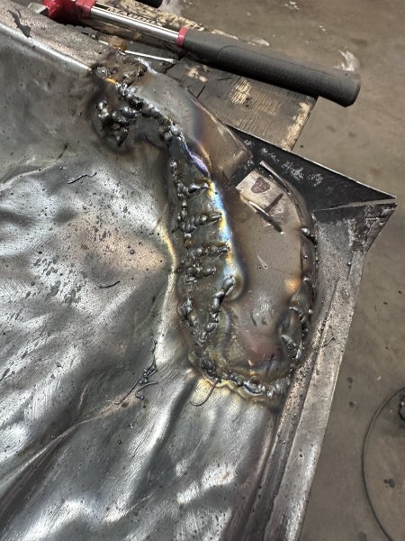

I'll add a bit more weld to smooth things out. Now, onto those humpy bits....
