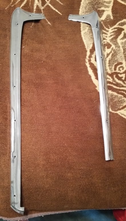

Does anyone know a source for moulding fabrication? Having had no luck finding repro or OE pieces for convertible moulding for my 65 satellite convertible, I'm wondering if there might be a shop that can repair the set I have. One complication is about 1/3 of the driver's side piece I have is missing. So, someone would have to fabricate that part and weld it before it's re-chromed. The passenger side piece is in great shape. Anyone ever have this done or have a lead?

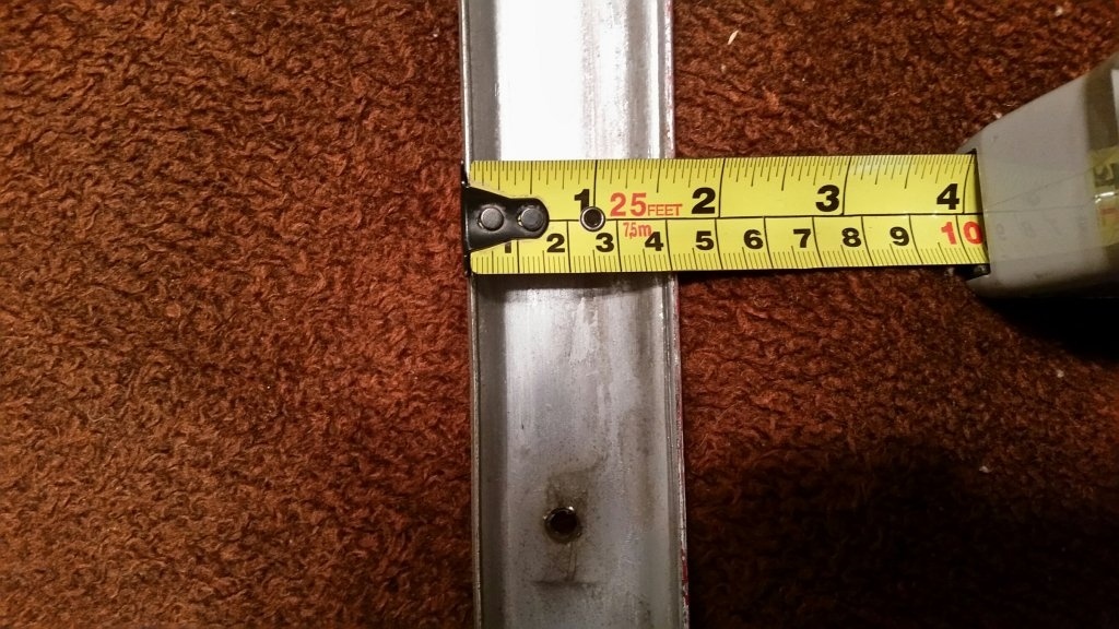

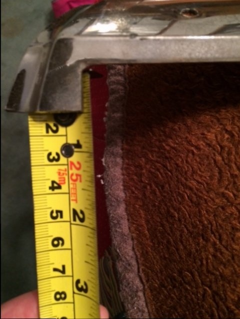

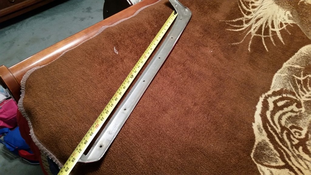

I have them here in front of me going to take some measurements and get back to you. Apparently I have a set of hens teeth..LOL
