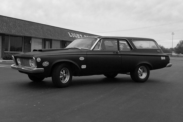

We did this on our AWB wagon and to be honest, it seemed like no big deal compared to all of the other crazy mods we were tackling. We nailed it down in an evening. (finished body work aside) Having a 2dr donor car is critical, especially for the 2dr B-pillar. We searched forever for a 2dr donor that would never be restored and did consider lengthening our front 4rd doors with an extra set. Thankfully we found a car to give up it's bits.
Remember that almost all of our car's sheet metal is connected with spot welds, so it's just a matter of finding them and drilling them out. Then lots of careful measurements and weld them in their new position. Obviously it's slightly more than this brief description but you get the jist.
You also want the rear side windows, frames, glass and all other associated parts with your 2dr donor.
Good luck

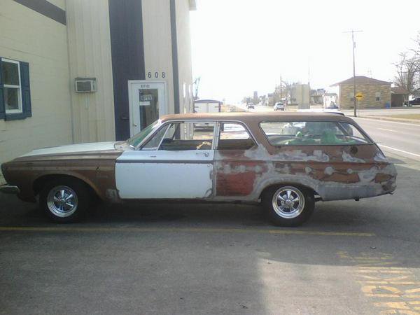

2dr wagon conversion
Here's mine that I did. Pretty straight forward honestly. If you have a 2dr and 4dr side by side without interior you can see exactly what I mean.
Making one a 2dr ht would even be easier.
I had tons of pics but lost them on my other computer.

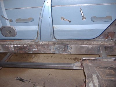

http://www.1962to1965mopar.ornocar.com/zimmerman65.html
there is a link to photobucket at that bottom of the page
That's an excellent link with good pics!
One main thing to remember when converting one is that you need to remove or open up the original rear door areas upper rocker area (area where sills went) before welding in new quarter sections. This allows for drainage of water back into rockers that gets past 1/4 windows and drains out lower rocker drains. Otherwise water will sit inside new area and cause rust issues or just overflowing inside and soaking carpets and rear foot wells...self experience talking here.
