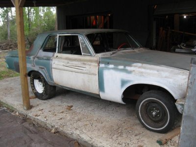

Here's mine that I did. Pretty straight forward honestly. If you have a 2dr and 4dr side by side without interior you can see exactly what I mean.
Making one a 2dr ht would even be easier.
I had tons of pics but lost them on my other computer.
Making a four-door sedan into a 2dr hardtop requires changing the entire roof!

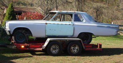

Here's mine, started as a four door. Converted to a two door and given the 10/15 altered wheelbase treatment. 0006.jpg
:headbang:looking pretty good :headbang:
