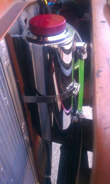

Overflow can! Get one It helped me leaving coolant all over the place is not cool (no pun intended) and if you ever step on to the track for fun you will have to have it. I got this one -
ill try this then thanks. also I did not kmnow a cooling system can be over filled... is this true? been workin on cars for some time now and built this wholecar. just sounds like something I ahouldve known if its true
I got this can cuz it has the visual tube on the front, I mounted it in front of the car opposite the rad driver side. At first I had mine over filled and when hot it would spew out the bleed hole on the top of the lid, drained some out so the tube shows 1/4 to 1/2 full and the rad is just about a 1/4" below the top and it runs cool and stays like that all the time. It is just what it is a catch can the rad over flows to it and takes it back when needed. works like a charm and looks good. good price too got mine from Summit $76.95 there are a lot of choices from summit or jegs etc..I just wanted what i wanted for catch and return not just catch.
