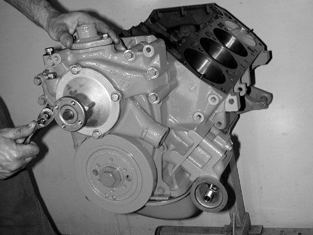

Where is the coolant temp sender on a 69 383 Super Bee?? I haven't been under the car to look yet, but I can't find it anywhere looking from the top of the motor......
I must be missing something......
Look on the front of the engine from up top. The sending unit is mounted in the water pump housing, right around the heater hose nipples.
Been there.....there are 3 spots...2 have heater hoses and the third has a pipe plug.
In the photo the sender is pointing straight at you
From the ratchet, got two bolts up, make a right turn, it's right there between that second bolt and the pipe plug to the right of the sender
I will take another look..maybe I missed it behind the alt bracket and harness. Will update in the morning..thanks
Yes on a 69 pump housing is on the pass by the hose nipples. On earlier ones like 62-65 its on the drivers side of the housing
Found it!! Thanks guys!!!! Tiny little sucker.....
