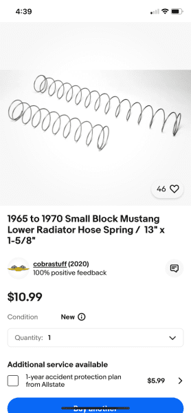

Anyone know where to get this lower hose spring?
This is the one I used from eBay worked and fit perfect in my 69 roadrunner

Ok, so any 13x1 5/8 should work?
Yes this is stainless so it won’t rust.I have run with and without a spring definitely will keep your hose from collapsing if you install one. Years back I remember them having one in the bottom hose seems like all the newer ones don’t

I use those Mustang springs in the lower hose as well. I have ripped apart more than one old mopar in my day, and have found springs in quite few of the lower hoses.
Shopping for one right now

Hard to believe all the major parts stores around here don’t list any rad hose springs… only found the one on ebay

The purpose of the spring in the I.D. of the lower radiator hose is to prevent high RPM water pump operation (suction pressure) from collapsing the hose, starving the pump causing over heating due to lack of coolant flow......

Yes….was hoping to find one locally
QUIT LOOKING....as most of the manufacturers have redesigned the hose's cross section area, thru the internal reinforcement chords and overall hose material to NOT NEED the metallic spring.....less costly to produce.....use one of the green Goodyear high temp offerings...slightly more $$....no one will know your hose does not have the spring......
