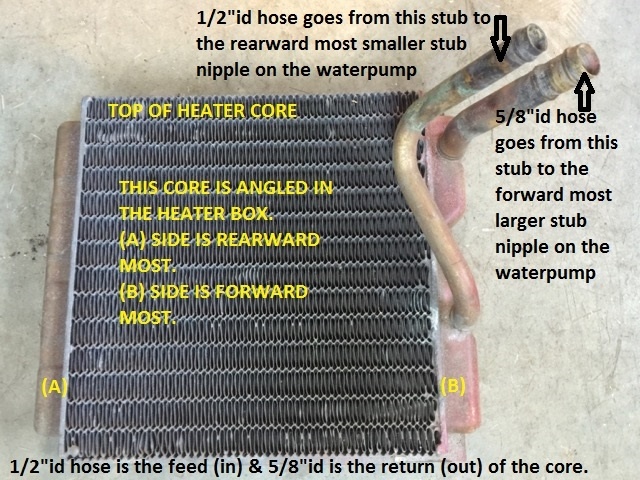

Non AC, water will flow either way.
Edit: I should add something here at this time, please correct me if I'm wrong.
The B, RB and 426 Hemi water pump are the same item, and the water flows only one way though the water pump and also water flows out the rearward most stub/nipple (outlet) and in the forward most stub/nipple (inlet).
Water flows in the smaller heater core stub (inlet) and out the larger heater core stub (outlet).
Now I do not know at this time if the heater core stub diameters are the same for the 426 Hemi compared to the B&RB motors.
I'd say only one way is correct.
The different size heater hoses is a 1970 & later thing. 69 & earlier had two 5/8" hoses & the heater core would work the same no matter which way you hook them up.
