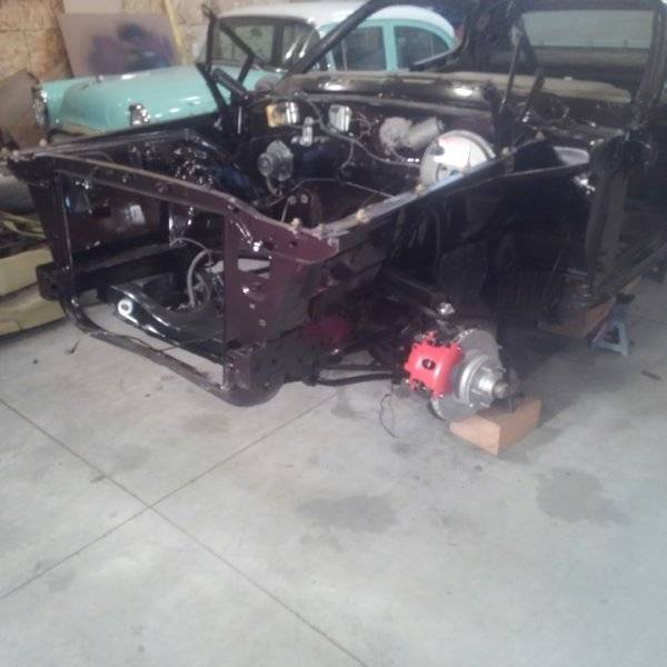

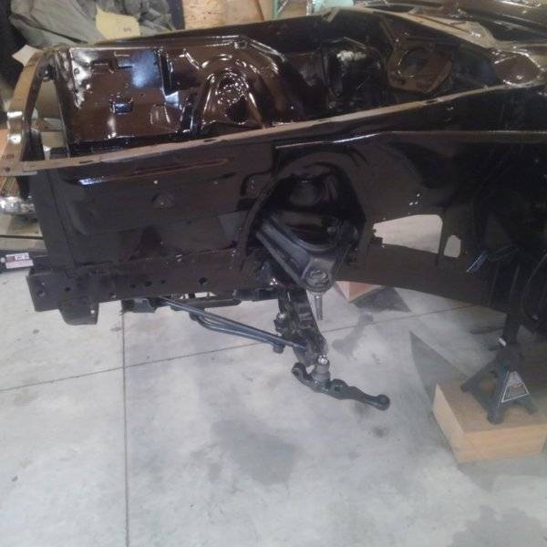

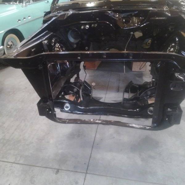

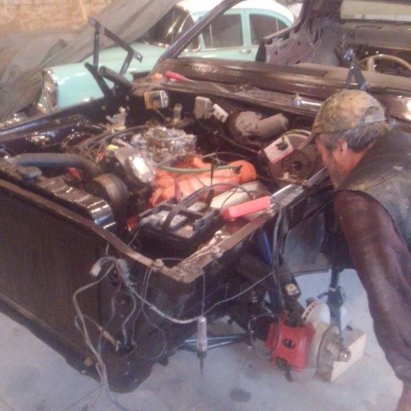

It’s a specialty socket, PST sells one, Mancini also but they’re overpriced is you ask me. I bought this one from summit and have no issues with itThis morning I got the k frame back in and most of the front suspension back together. Now I am looking for a socket for the upper ball joints.
View attachment 530525 View attachment 530526 View attachment 530527
