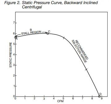

Manufacturers test their equipment under a variety of conditions and plot fan performance on a “Fan Curve Chart.” This is useful for predicting how the performance changes as other variables change.

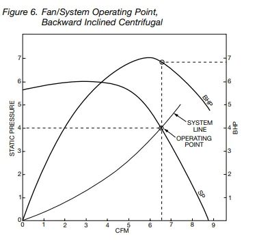

Fan curve charts look different from manufacturer to manufacturer. Most look like a graph shown below. The curve represents a constant RPM for a specific model. Plot a horizontal line starting at the static pressure axis until it intersects with the curve. Then plot another line straight down to the CFM axis. This is the CFM at those conditions.
Some manufacturers add a brake horsepower (BHP) curve to this chart to show how much power is required to do the work we are asking the fan to do at a given RPM and SP. This intersection is called the operating point. When a BHP curve is added, we can determine the horsepower required by plotting a vertical line up from our operating point to intersect with the BHP curve.
Using the 3 Fan Laws with a Fan Curve Chart
The manufacturer will always provide a “system line” representing the path the fan has to stay on as conditions around it change. Any point plotted on the chart must be along the system line. Once an operating point can be plotted on a fan curve chart at a known RPM, we can now use the 3 fan laws to predict what will happen if RPM or SP changes. CFM and horsepower will change with RPM and SP changes.
The curve for a propeller type fan is slightly different but the fan laws apply. The selection of the fan is determined by many factors including cost and operating conditions.........FYI

Sure it did...perhaps you just don't understand....search for propeller fans, select your diameter, pitch angle, operating RPM, to see static pressure and CFM....the fan laws apply....there is no yes/no answer...you have to determine conditions and requirements or are you waiting for someone to make the determination for you?.....
