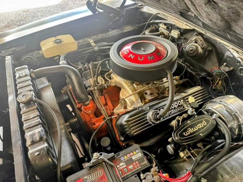

I took out my 440 Charger today which was a hot day..I drove the car today, and when I was in traffic, the temp gauge went to 220, then just over to the next mark. Maybe 230? The coolant was completely topped up when I started the journey..I went to have some tracking done and the car was off for about 30 minutes...when I started it again it still read 220..If I'm moving at a decent speed, it goes down to about 190... Is it running too hot? Or is that about right or could the gauge be faulty..

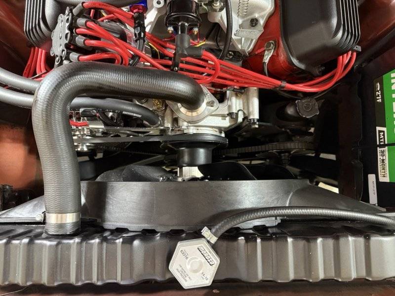

Yup, that's getting very hot. Need more info though, are you running stock fan or electric? Got a shroud?
It's the stock fan and Radiator
It drops to about 190 when it's on the motorway but otherwise stays at 220..The fan is working properly..I noticed today after I turned it off for 10 minutes and restarted it that the gauge hadn't dropped and still red 220

did you check lower hose? Do you have a fan shroud? Is this all original stuff on the car fan,shroud and radiator? Did it run fine for years and now problem? Add a mechanical temp gauge to see if factory gauge is working correct. Does your car puke out anti freeze when turning off? Still need more information to help.
