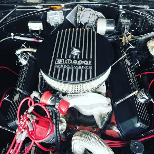

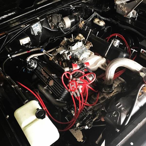

My 360 runs at 210-212 degrees at a dead stop at about 80 degrees here in Alabama. I’m concerned because once it gets really “Alabama hot” i might have some serious cooling problems. My current setup is a 190 thermostat, a stock shroud and radiator, and a five blade aftermarket fan. Any advice for keeping her a little cooler? I’ve read water wetter does a hell of a job but I’d prefer not to drop my 50/50 antifreeze ratio.

70996027-2F93-4CCF-B6BB-979C6BB0706C.jpeg 0A0F8E23-42E0-44BA-B8CE-09CA66597965.jpeg
Get the radiator boiled out. 7 blade mopar fan with clutch. 180 stat. 1 gal coolant, the rest water.( you ain't freezing anytime soon down there) . 16 lb cap.

I installed a 3 row champion Raditor with a over flow tank. The over flow tank helps alot ended some 50/50 in there for reserve. Temp gauge doesn’t even get passed the middle.
