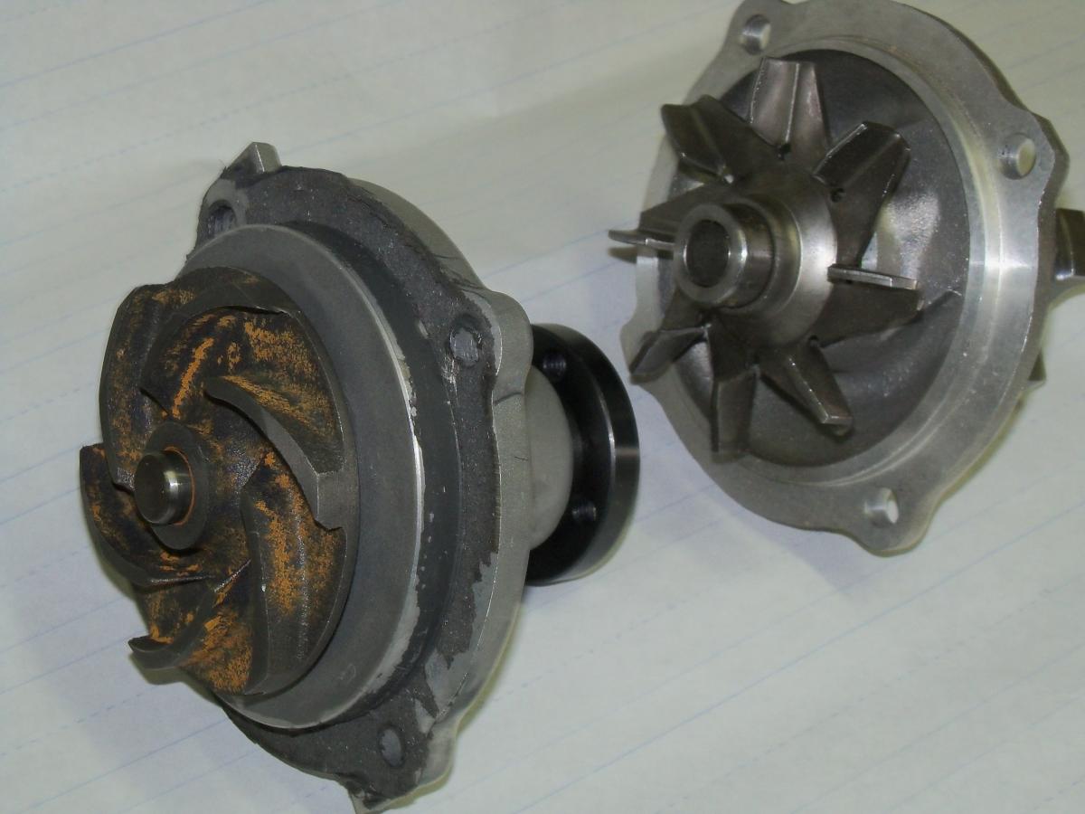

Cooling system fix
Thanks to everyone for helping me solve my cooling system problem.
The solution was to get a mopar performance 8 blade water pump which did the trick.
The previous one installed was a 440 source unit which look cut back for race applications - wrong application.
Thought I would share this photo with the group. The smooth circular one is from 440 source.
Ralph
That's funny, I have a 440 source pump (and housing) and my impeller looks like the MP unit in the pic above.
You never know what you are going to get with their stuff. They must source through whichever chinese factory is the cheapest at that moment so stuff varies.
The problem with their housing is that the inlet and outlet are severely undersized. Mine doens't have that problem but it's hard to say why they would do something so far off. Mine does have the temperature port drilled all cockeyed which looks funny but seems to work just fine.
I know a lot of people run their heads... not sure I could trust them.
